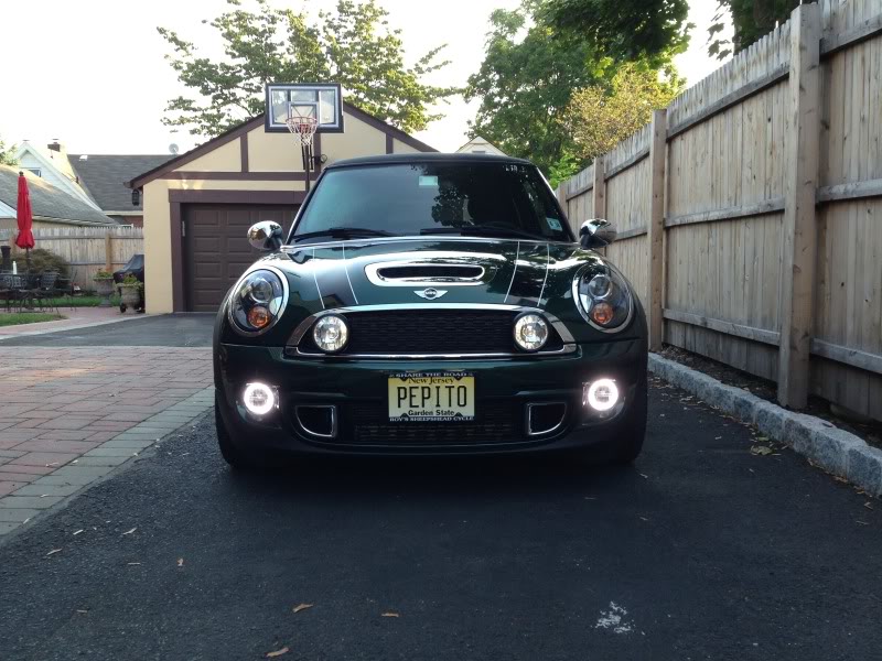

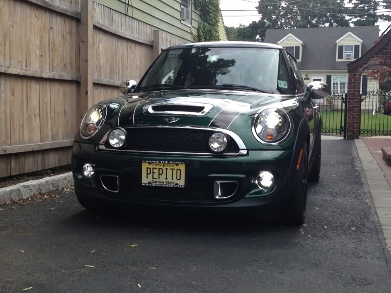

I did mine yesterday, bought the lights from the UK so $460ish with shipping, ordered last Tuesday got them on Friday. One note on the install instructions, the control module in the footwell has two large pin connectors and the instructions say to tap into the wire of pin 12 on the 51 pin connector which is wrong, you tap into the wire of pin 12 on the 53 pin connector which in my car the wire is grey and connector is black, otherwise everything else is straight forward and plug n' play. took me 2 1/2 hours but I had to remove the driving lights to get the grill removed

Nice job!! They look awesome!!

Crazy bright right?

For sure, I really like the transition from DRL to headlights on with the top quarter lit. Very happy with the result and they don't look cheesy like the aftermarket stuff

Those new Audi's and BMW's ain't got nothing on us now! My fav part is seeing the halo reflection on bumpers and store windows. Looks way cool. Head turner for sure. Did you remove front bumper or headlights?

No, just loosened bumper enough to have space, removed left headlight to route wire harness. Off to work now so I can buy more mods

Congrats, man!
They look fantastic!
Great pics btw!
