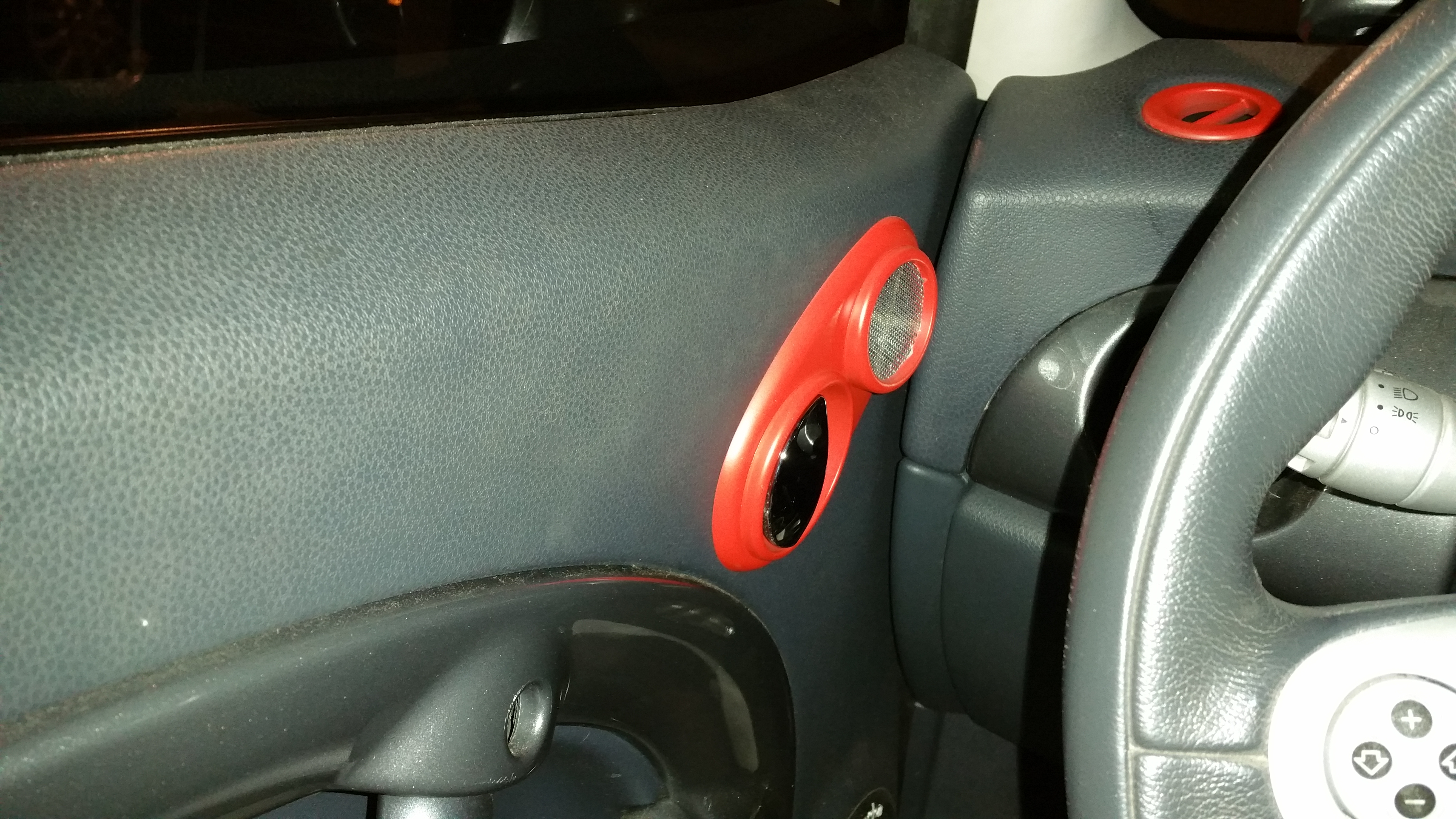

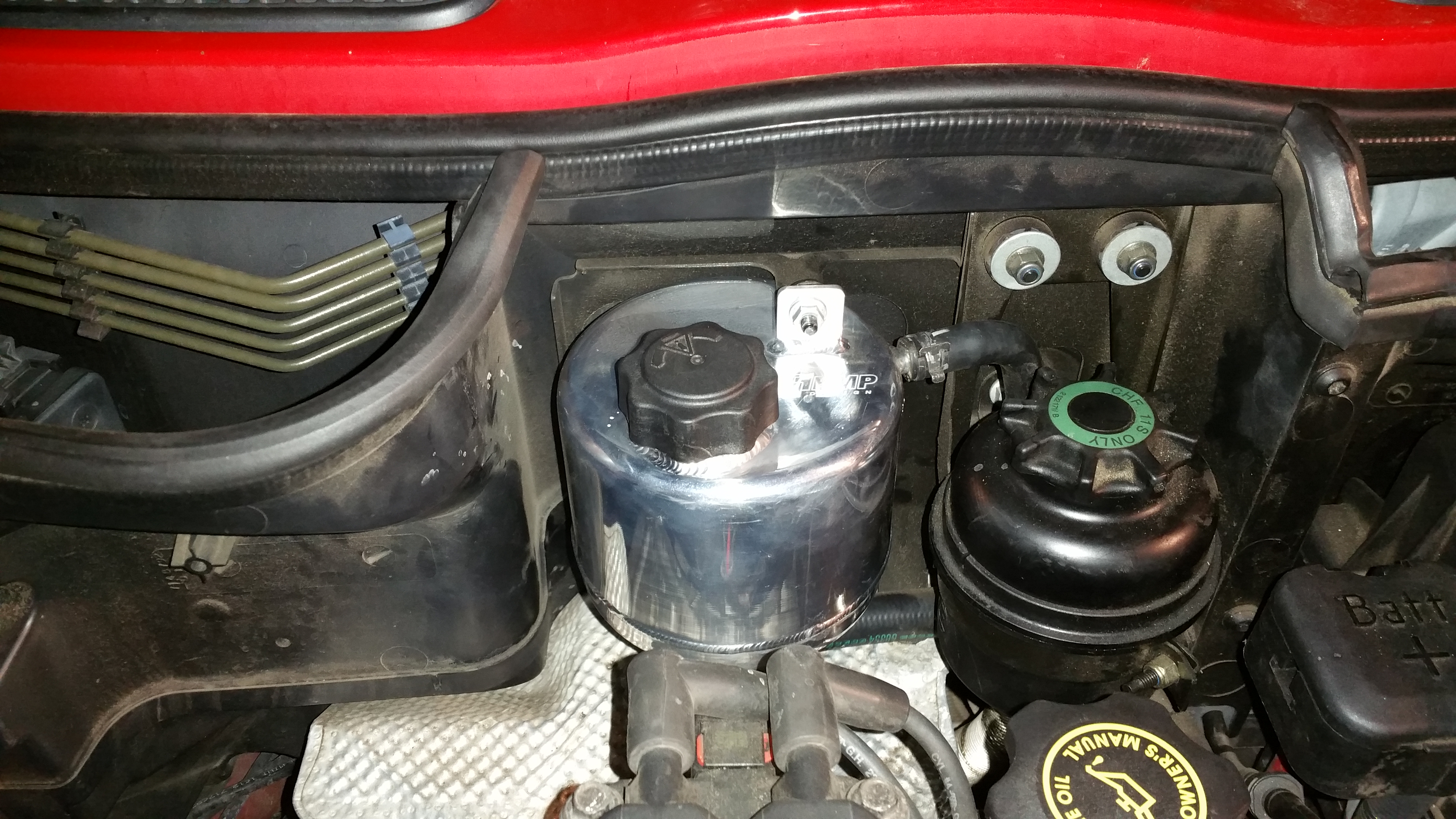

Yesterday I installed a new Strut mount on the drivers side, a polished aluminum coolant expansion tank, and did some plastidip work on some of the interior trim. I think it came out pretty good so far.
Attached Thumbnails What did you do to your mini today?-20161031_054754.jpg   What did you do to your mini today?-20161031_054814.jpg   What did you do to your mini today?-20161031_054901.jpg

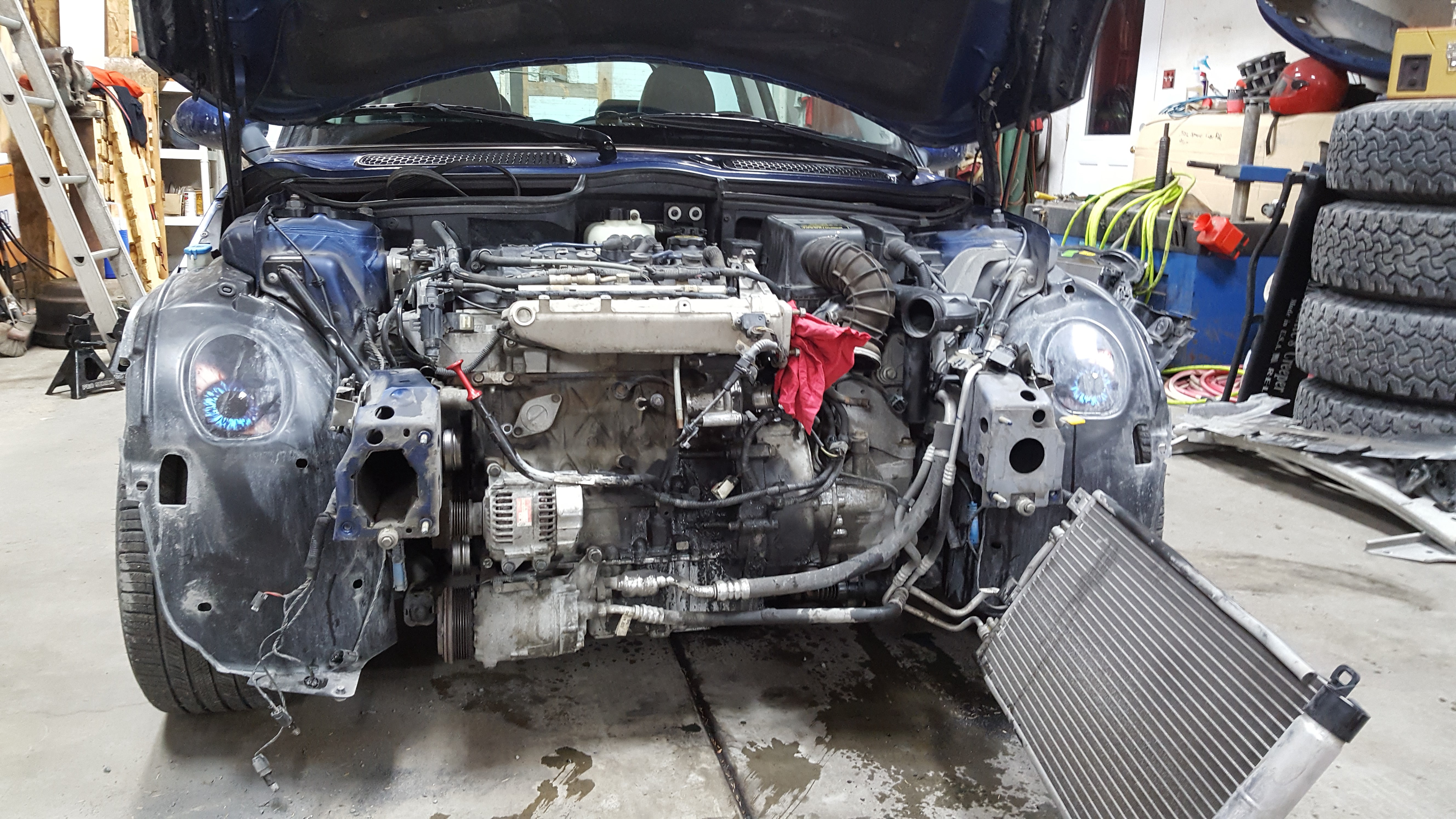

I removed the front clip. Removed and inspected the supercharger. Oil in front housing was just a little low, but looked great. The oil in the PTO housing was very low (just a few drops came out), but was clean. Interestingly, it appears that the seal between the s/c and the PTO housing had failed and contributed to the sticky and stinky oily mess on the engine. I inspected the PTO gears and found that they were still in great shape - whew, dodged a bullet there!
I started cleaning up the oily mess on the engine. So far this has taken me more time than disassembly!
The dipstick tube seal looked like it had been leaking, so I replaced that.
Tonight (or perhaps, tomorrow) I'll be cleaning the supercharger and water pump. Will reseal the PTO housing with new anaerobic sealant and refill with fresh new GM supercharger oil.
Attached Thumbnails What did you do to your mini today?-20161101_204528.jpg   What did you do to your mini today?-20161102_180905.jpg

Good job! Looks a lot cleaner in there now.

Thanks! I've got more to clean, like the timing chain cover and around the oil pan. I'm not sure if these are leaking or not, but there's no way to figure it out until I get it all clean and monitor it. The oil pan gasket and crankshaft sensor were replaced under warranty back in 2007ish.
I looked inside the supercharger and the rotors are in fantastic shape - no discernible wear!
I wish more cars had modular front clips. Seems only certain European cars I've worked on have these (MINI, BMW, Audi). Nice that they come apart fairly quickly, leaving you with a ton of room to work on the engine.

Nice! So much time spent on cleaning... I do recall that... Honestly, if the oil pan gasket was changed in 2007, it might be time to do it again? With the Mini all apart, now would be the time since it is easier to get to, no? Then you have piece of mind. Part is maybe $20-30...
That is excellent news on the charger and rotors. I am thinking I will do the same this winter while swapping out the water pump just to prolong the life of the charger and side step the expense.
Agreed... first time I took the front end off, I was a little stressed about which bolt went where, the process... now, you just start ripping into it and within a short period of time, everything is apart and you have access to what you need to get to. That is a nice feature for sure.

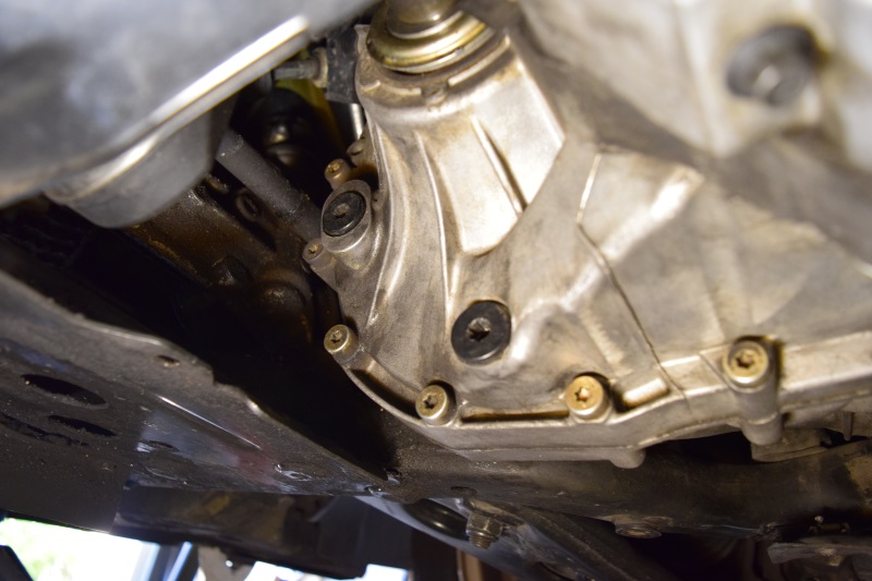

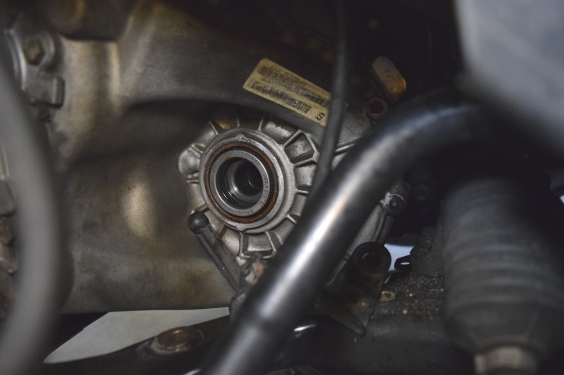

Took the time to swap out my starting to leak driver side axle, driver side inner ball joint, driver side lower control arm and changed the transmission fluid. Swapped from the MINI lifetime fluid (hehe) to Red Line transmission fluid. Rotated the tires while I was at it.
More pics in my thread.
