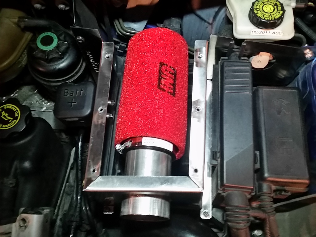

Installed a DDMWorks cold air intake, UNI filter, and SAMCO silicone induction hose. (Thanks Way!)
Once I realized the hose needed to be trimmed a bit on both ends it went a lot easier.
Removing the old airbox and putting in the new one was easy.

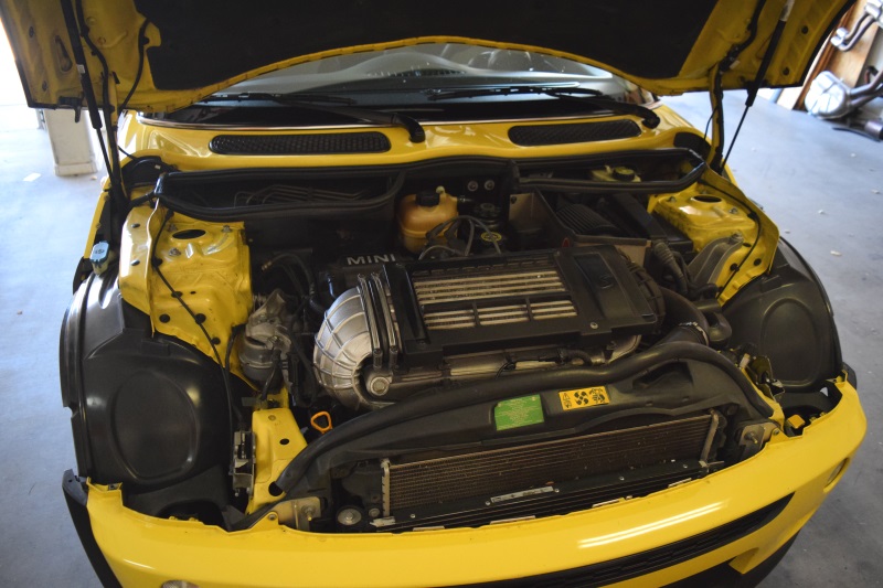

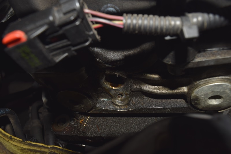

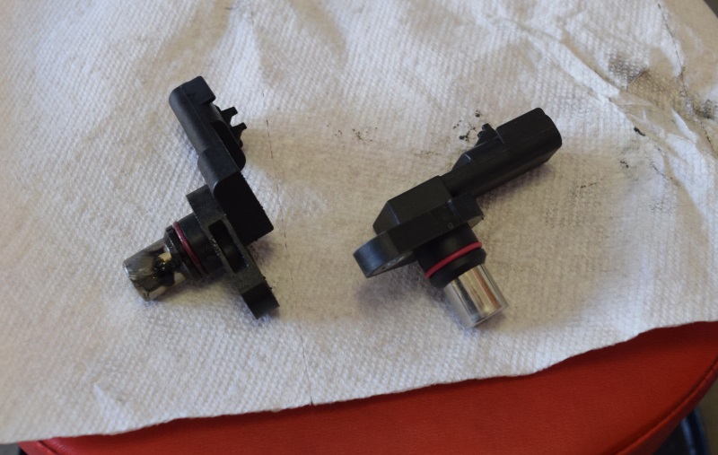

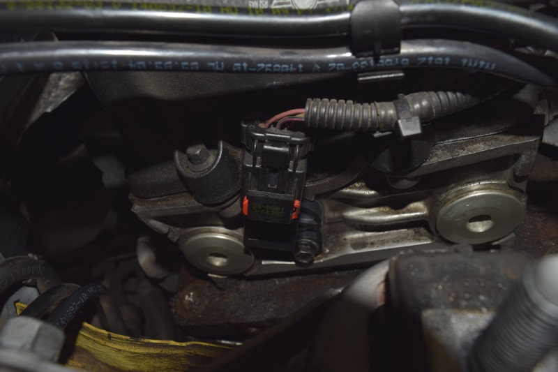

Replaced the camshaft position sensor that recently died. CEL code P0340.
Very straightforward process and he runs SIGNIFICANTLY different/better. Much more spunky now and alot more performance back. I guess that shows how bad my old sensor was…
More pics in my thread.

Awesome! So that did the trick? And did you have to take the engine mount out for that ?
