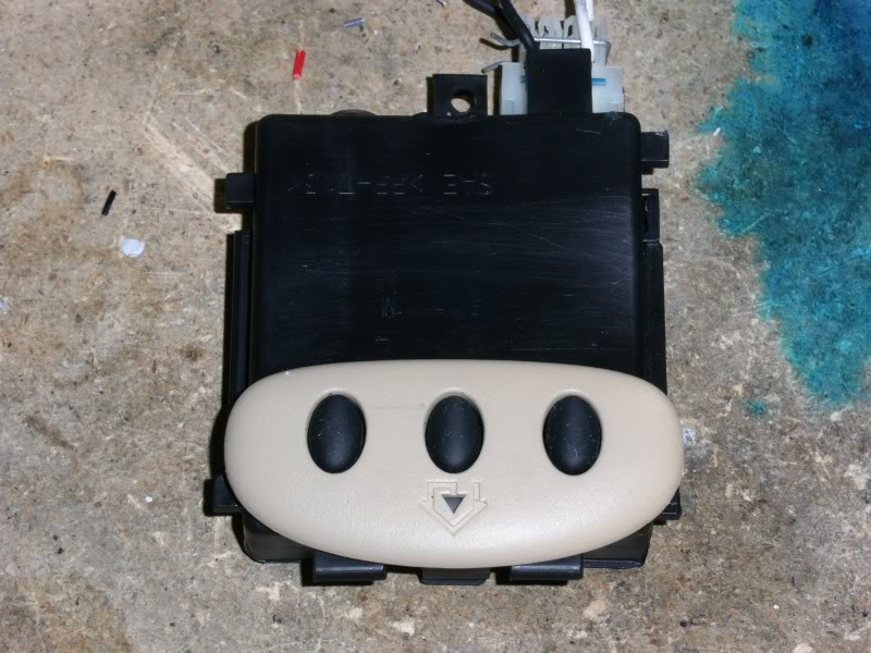

I did a Homelink OEM install in my R56 MCS last night. It's not a job for the feint of heart :D
I had to Dremmel out the roof console, tap into the purple/gray wire (2nd from the right on the black plug) for 12V power, screw the ground into the roof bold behind the sun roof mechanism, replace the F14 fuse after it blew from be screwing around with a multimeter, and now I'm stuck on trying to find a way to get the button plate to stick.
The unit looks similar to this, and the buttons are a rubber "membrane" with a plastic cover.
The buttons aren't quite long enough to reach the circuit board, so I added little "extenders" to them so they'd reach. Do people usually just end up gluing the plate to the console with these?

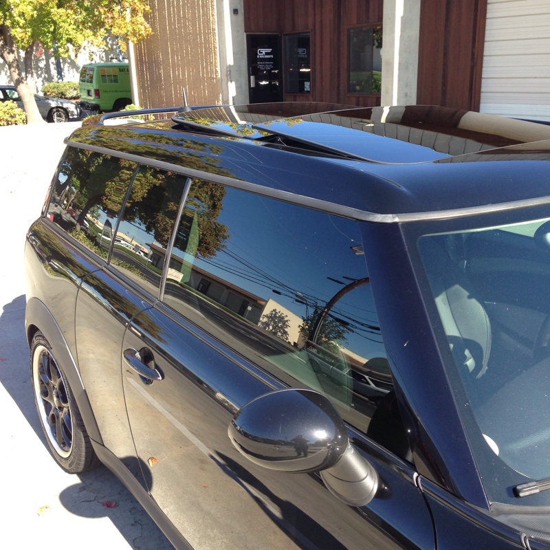

Dropped at GT Auto Concepts in Redwood City for DP install (akrapovic), GFB DV+, and new full exhaust. Cannot wait for the drive home tonight!!

Kudos in having the courage to work this mod, but I wasn't even aware it was possible. I do know there's a rearview mirror with Homelink built into it for retrofit, but unfortunately I don't know which circuits need to be activated to use it.

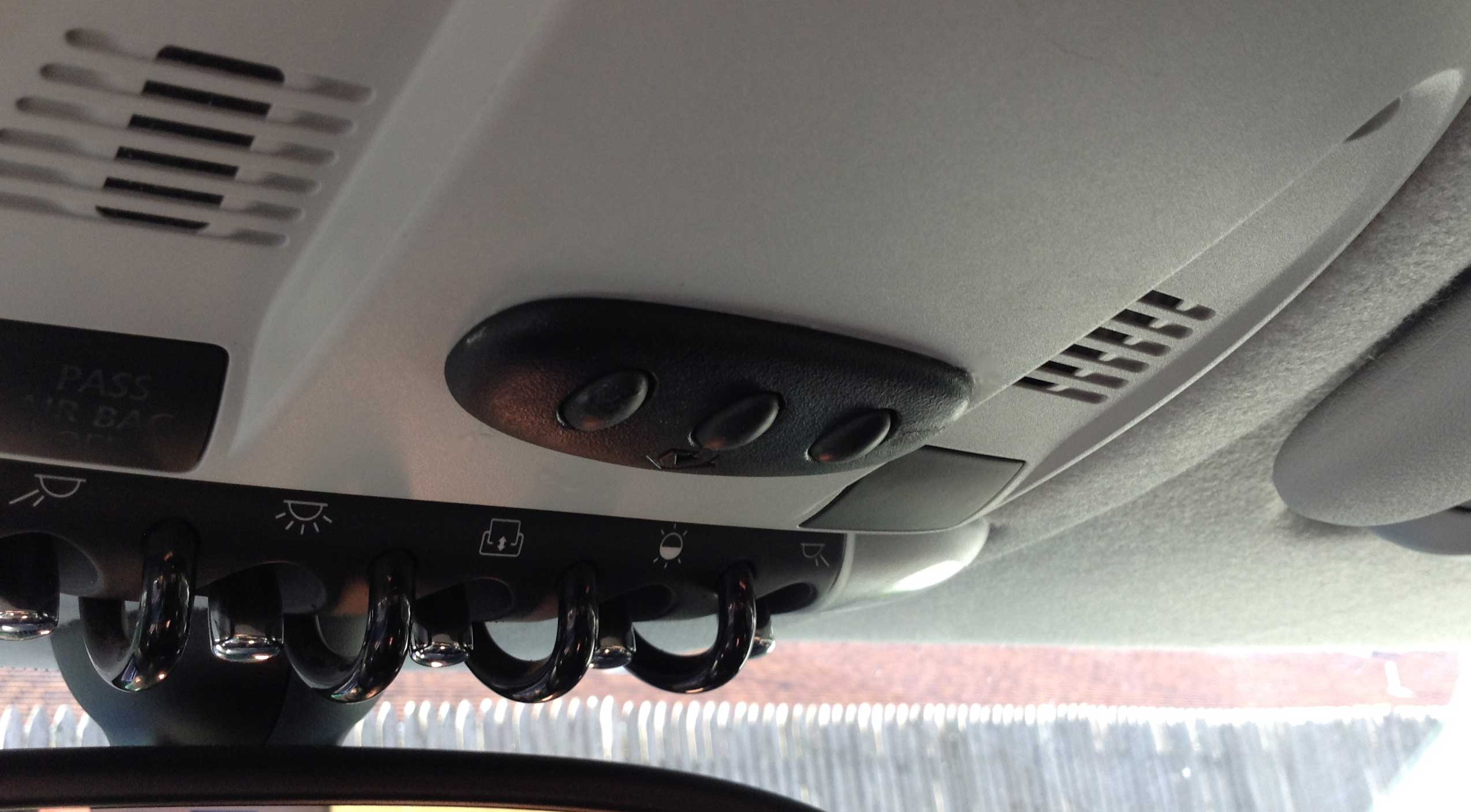

This was a $25 mod from eBay (well $29 after replacing my F14 fuse from poking around with a multimeter )
The R56 w/ Sunroof console cover just pops off, and there's two torx screws holding on the underlying black console. I unscrewed that, and there's a compartment in the middle meant to hold some kind of module. I was able to dremmel that area out to accommodate the Homelink casing so it fit flush, then I used a hot glue gun to secure it in place.
I then dremmeled a hole for the buttons into the gray console cover, glued it in place with some superglue, and put a clamp on it for a couple of hours so it would dry flush.
The rubber button posts didn't quite reach the buttons on the circuit board inside the console (as shown: )
Therefore, I glued 1/8" extensions on to the posts using a strand of rubber flashing I happened to have. Makes perfect contact now.
12v power was supplied by the thick purple wire on the black connector located inside the console (search the forum for the instructions on hooking up a radar detector). The only other thing needed is a ground, which is available with a 10mm bolt attached to the frame in that same area.
Here's the finished result. Not bad and it opens the garage door a block away from my house

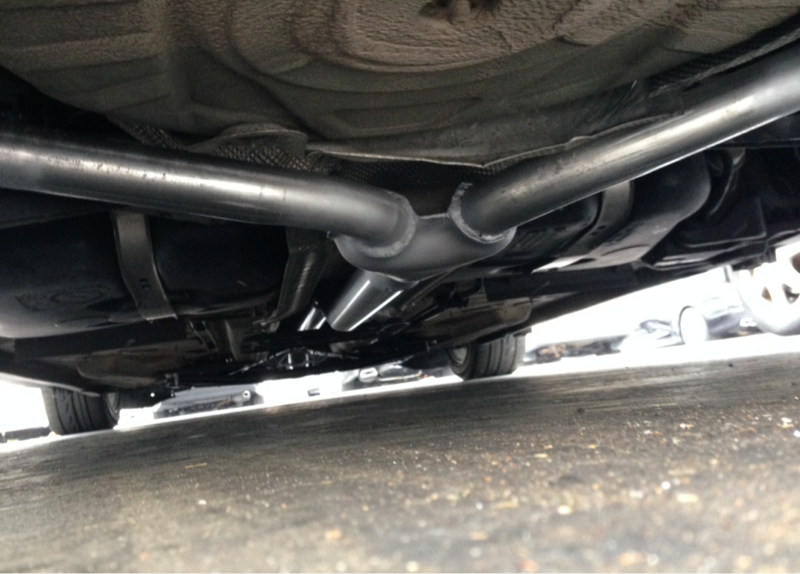

I really like the way they fabricated the cross pipe. Sounds fantastic, will take a video soon...
