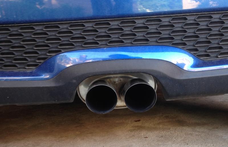

fJCW exhaust minus the cat

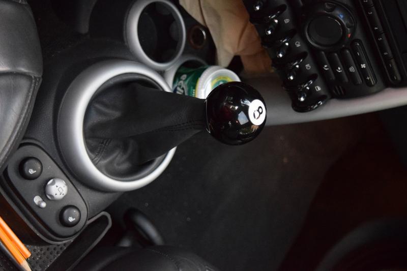

Today I finished installing my new shift **** - just a cheap unit from ebay, but it's fun!

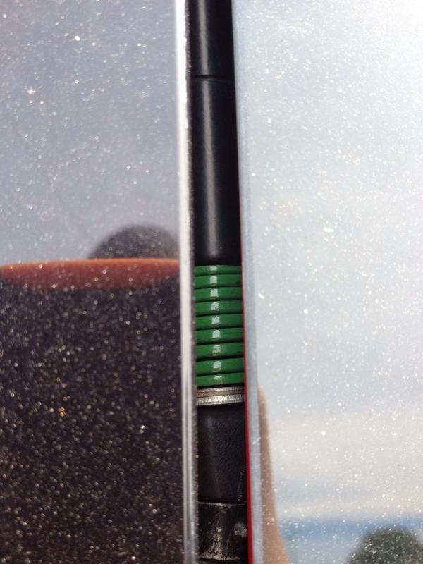

Installed die springs on the hatch. I wrapped electrical tape around the shaft so the spring wouldn't slide around as the hatch was opened/closed.

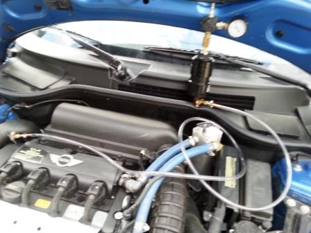

Sea Foam Rig
Built a rig to do Sea Foam treatments. Bought a misting nozzle and small two brass shut off valves. Built a contianer out of ABS plastic. Installed the nozzle and one shut valve in inlet hose on Mini and the other shut off valve in the bottom of container. Used clear plastic tubing to connect both. Attached my air regulator set to 30 psi to the container. Put 5 oz. of Sea Foam in the container and attached air hose. Started the car and opened valves while keeping engine at 2000 rpm. Took about 2 minutes for Sea Foam to empty. Worked great!
