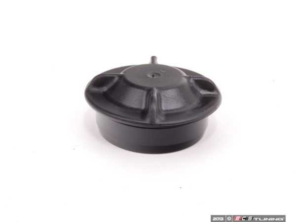

The Caps are part #3 in the diagram if you are missing one. Part # 31311139453
http://www.ecstuning.com/Search/SiteSearch/31311139453/ES49917/

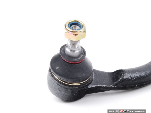

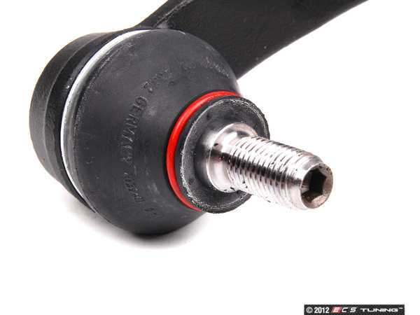

Dumb question... how do you get the nut back on the tie rod? the shaft is spinning with the nut and I don't see a way to hold it with a wrench

Counter-hold the tie rod ball joint with a hex wrench and torque the new self-locking nut to 52Nm (38 ft/lbs.) as you tighten the nut, it will seat the ball joint in the steering knuckle.

You will need to get a allen socket w/ ratchet or hex wrench. I like to use allen socket and ratchet better. And a Box end wrench for the nut. I would clean out the top hole if there is crud in it do the hex / allen head will fit all the way down in. I have seen people strip them then have to C clamp the top of the stud to the bottom of the tie rod to get the nylon lock nut off. Then torque to spec with the new tie rod and nut.
The nuts have nylon washer in the nut so it will not back off.
