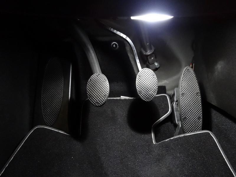

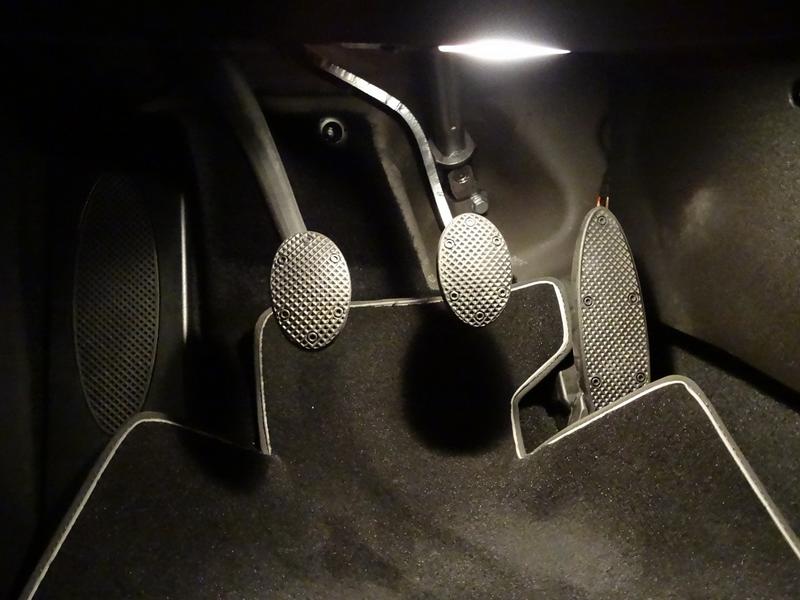

I installed my interior LED light set from ECS. I purchased their R57 9 piece set which appeared to be exactly what I needed for my Coupe. My guess is it is also the correct set for an R59. Before install I labeled each package so I would be able to swap without confusion. G - Glove compartment, 2 X FW - Footwell, 3 X FD - Front dome, 2 X D - Doors, T - Trunk.
I started in the trunk. With a plastic trim removal set I was able to pop out the light in less than 30 seconds. Most of the locations were accessed in less than a couple of minutes. A couple of lamps were difficult to install in the housings because of limited space, the footwell lamps in particular. The hardest light was the dome lamp. I couldn't follow the directions because moulding wraps around the pry locations. I actually gave up for a while. I noticed the front dome protruded and almost acted like a handle. In frustration I grabbed the "handle" and applied downward pressure, and the front popped out. Spring clips held the dome in the rear. The total swap took 1 hr 15 minutes. It would have take just under 1 hr if I didn't give up.
I'm really enjoying the "natural" light and total increase in light output. My guess is the LEDs are about 5000K in color temperature, compared to probably 2700K on the old lamps. The attached pics were taken under the same conditions. My garage was closed with my garage lights on, at the same time of the day. I can post other pics if requested.
They look great!
Where exactly did you bought them?
I would like to change mine too.

Thanks! The difference at night is crazy good! Attached a few more pics. The dome light was the most difficult to remove. Here is a link to the exact set I purchased. If you want to see the other sets they sell just type LED in the search box.
http://www.ecstuning.com/Search/Site...Led/ES2608259/
Attached Thumbnails What did you do to your mini today?-footwell-before.jpg   What did you do to your mini today?-footwell-after.jpg   What did you do to your mini today?-dome.jpg
