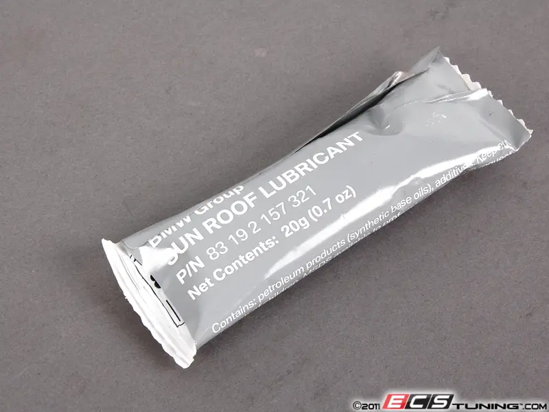

WD40 or PB blaster up the cables and on the pivots.
Then I use something similar to the sunroof grease for the places that contact the latch. Also good for the convertible top and sunroof cables.
https://www.ecstuning.com/b-genuine-...83192157321kt/
