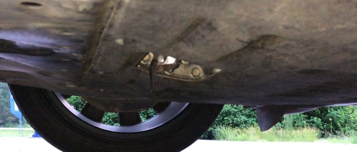

So for the curious, this is what I've found under the car in terms of extent of damage: not much.
- The turbocharger air discharge duct had its rubber end mostly ripped off. The metal it was attached to got bent a little, but it's flexible (you can bend it by hand) and its shape was mostly retained.
- Small hole punched in the service flap for the engine oil drain.
- 1 of 2 rotating clips securing the service flap for the oil filter damaged but not unusable.
- Front muffler got bonked by the road object. Visual scuffing, minor dent in visible impact location that you can feel, about the size of a thumbprint (meaning: meh).
So basically the big rectangular airbox that someone left under the road went under the MINI a bit left of centerline, ultimately winding up at centerline, and did about as much damage as one might expect as it got crunched into smaller pieces too short/small to touch the vehicle.
I am simultaneously (1) a bit surprised by the puncture in the service flap for the engine oil drain and (2) glad that whole underbody shield is there. Being accustomed to working on a vehicle with no such shield, its presence annoys me come service time, especially as the plastic anchors the bolts securing it screw into age. But in terms of handling unexpected road debris, did its job. I'll creatively patch the small hole.

Speaks for itself
As I look at this I think I see an impact track higher in the pic (top of frame = front of car) but the net is that metal (car) won over plastic (road debris).

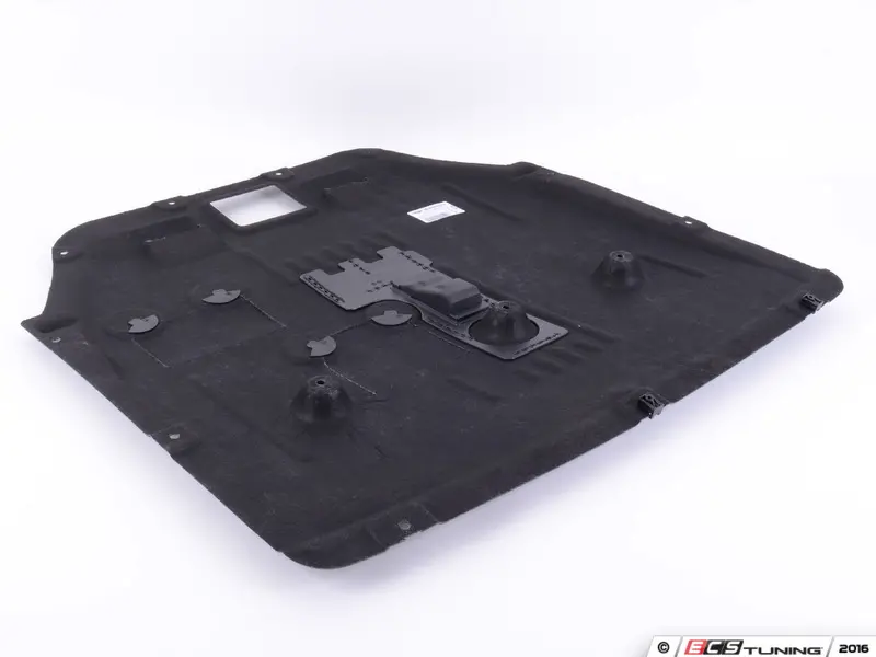

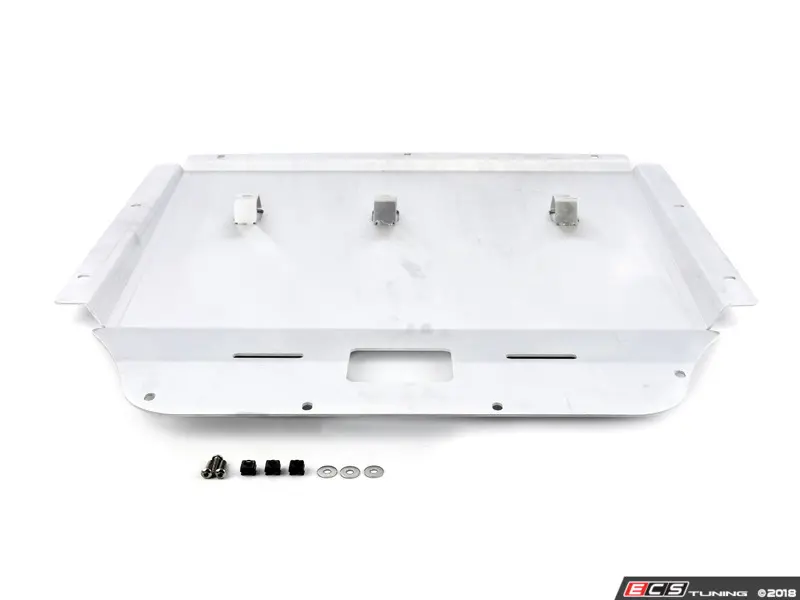

Glad it did not hurt more, down the road if the fabric tears or goes we have them here or you can go with a skid plate for the future.
For the Gen 3 MINI this is the first time they used a fabric underbelly panel (aka fabric skid plate), does not really skid, just light protection.
Compared to the Genuine, our Bremmen Parts version is a little more robust on the fabric weave.
https://www.ecstuning.com/Search/Sit...h/51757343141/
Before that the JCW GP2 (that pan i have on my R58 JCW and saved it from a deer remains) was the first after that it was the JCW Countryman/ Paceman, before that its was a front panel or side panel, no full protection.
