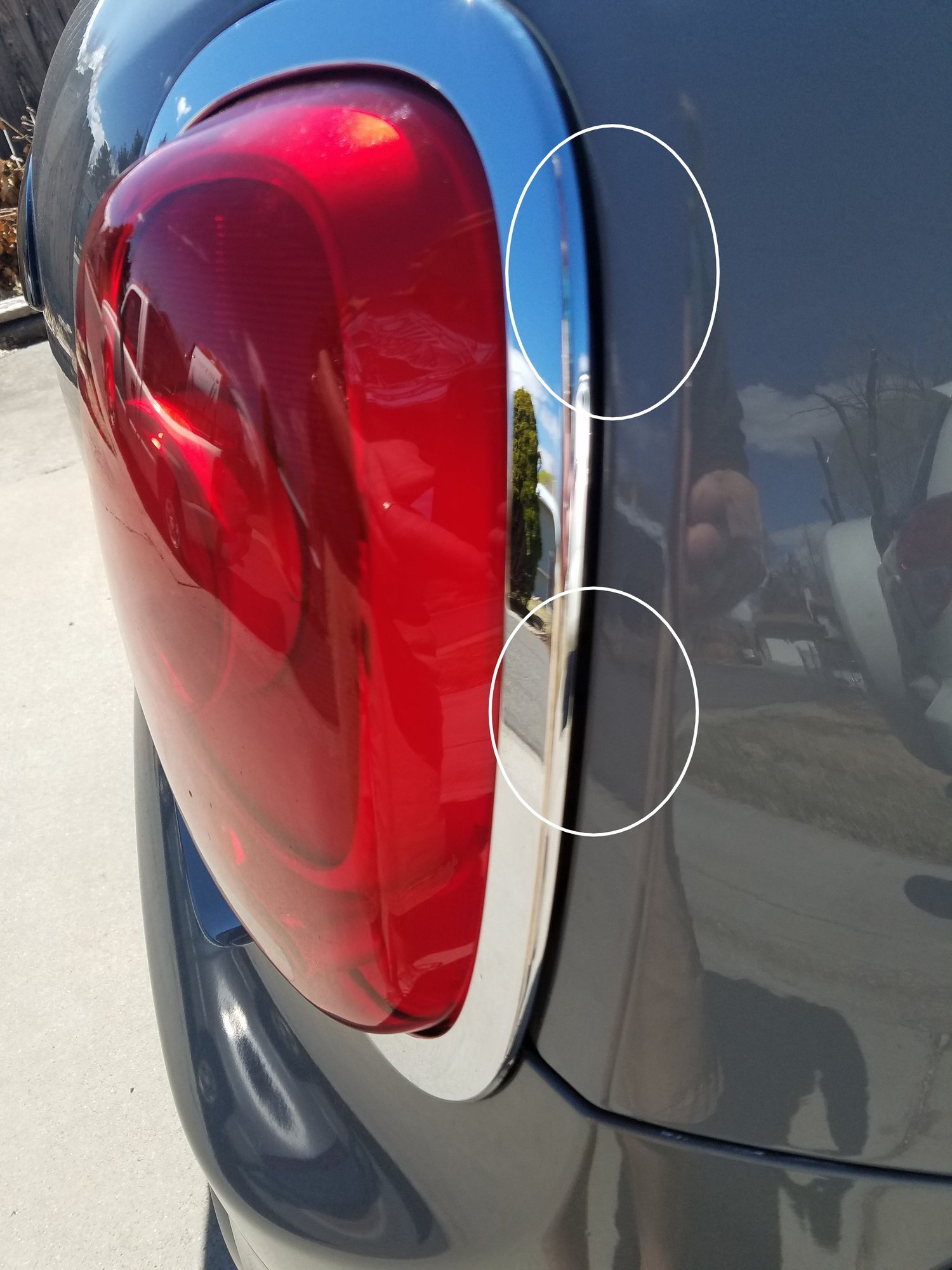

Okay, so I went back and tried this. Pulled out the light housing, and ran the screws all the way in. They bottomed out, and the head was sitting flush against the body. Once I reinstalled the housing and put the screws back in I made sure they were as tight as I could get them (broke two harbor freight drivers tightening them up!) and....the trim still wouldn't snap on. I'm sort of at a loss here. I put a picture below of the two clips I'm having trouble with.

Ah - my surround was left with a big gap at the top and outside top
Have you checked the tabs on the surround to make sure they haven't broken off?
Try removing the light again and fit the surround on the light while it's off the car to make sure it sits flush to the unit

That was actually what I did before I started reordering parts. The trim fits onto the light housing fine when it's not on the vehicle. It's only once I install it that it won't snap on. This is true for both the OE trim piece and the replacement that I bought. The tabs on the taillight itself don't seem to have a large overhang (like the ones on the inside of the light do) but I can't seem to even push the trim piece far enough on for it to pop over the tabs. It feels like it's physically impaired by something.
Edit/idea: Maybe I'm tightening the taillight housing in too much, and it's warping it, making it so that the trim can't snap in?

Have you tried fitting the side that doesn't sit flush first then working your way around the unit and then see if the other edge sits flush?

Yeah, the top right refuses to snap in at all, and the middle right will snap on, but immediately pops back off once I let go. This is when I try to put that side on first. I think once I grab some new torx drivers that I'll loosen the housing up a little, and see if that helps.

seems strange? i couldn't figure mine out until i removed the unit and made sure the trim fitted flush, then realised it was the unit not fitting flush to the car which was the problem, then figured it was the top screw not going in fully
I was going insane trying to figure it out, as you say it seems such any easy 2 min job?
