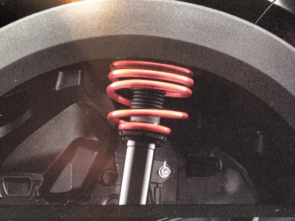

Old Jan 25, 2016 | 07:56 AM
Posts: 36,762
Likes: 2,551
With the adjustment tool like a coilover kit. Nuts that adjust on the tube with a special wrench in the kit. You can see it on the bottom of the red spring, what it sets on.

Old Jan 25, 2016 | 01:39 PM
honderpilot's Avatar
honderpilot
Joined: Jun 2014
Posts: 654
Do you have to take the wheels off the car every time you wanna adjust it?
Old Jan 25, 2016 | 01:49 PM
Posts: 36,762
Likes: 2,551
Its a tight fit when down all the way. Most people jack the car up if they cant reach , then with the widen gap adjust a little ( if you have bigger wheels this will be harder ), then drop it back down slowly. Drive down the road to set in. Then adjust again if needed. Count your turns and make note you match the other side the same. Rears you can get from the back underside some. As the coil is separate.
