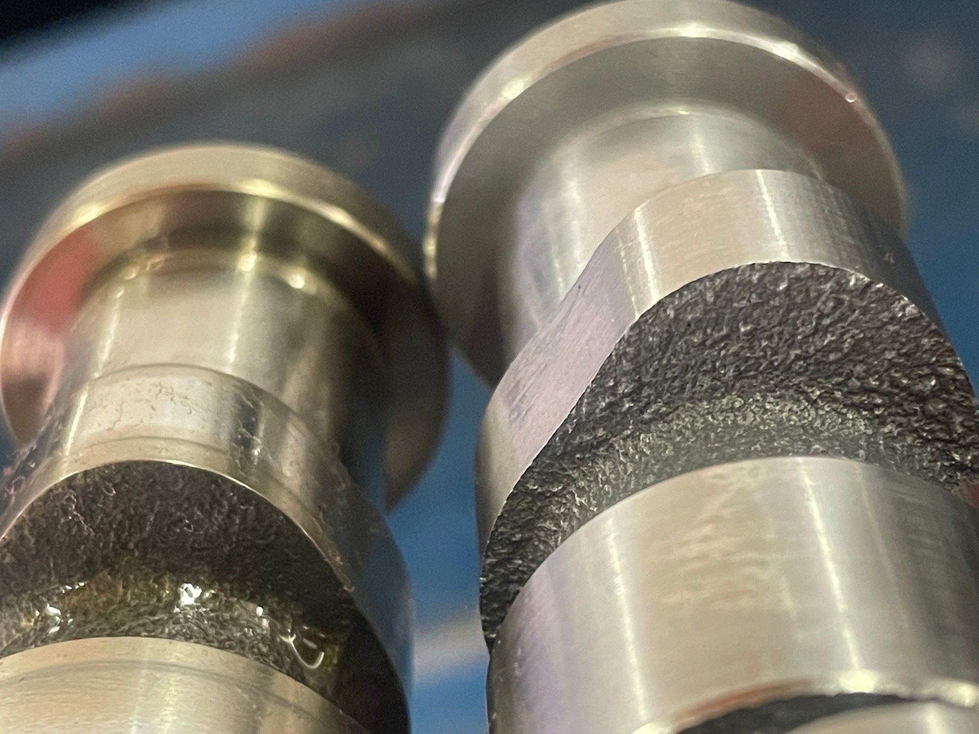

This camshaft has a lot more duration than stock and it seems it closes the intake valves more slowly. The best I could get trying to measure lift for comparison vs stock was a little under a millimeter on both (intake and exhaust) lobes. Mod Mini on YouTube installed this cam and measured it. He said it's about 1mm more lift so, we'll go with that.
This is a good view showing the difference in duration. The lobe is more "D" shaped than the stock lobe on the left.

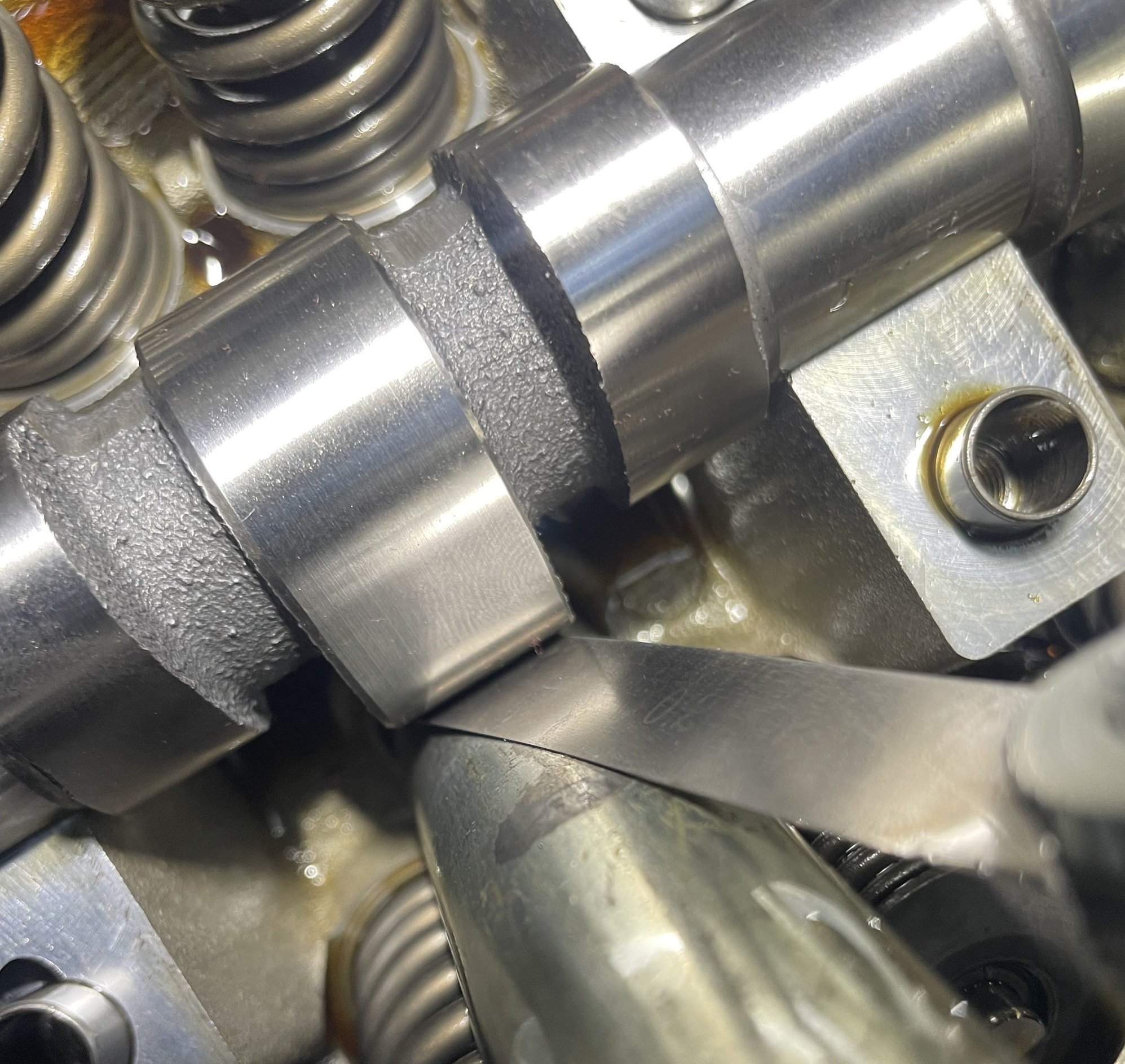

The W11 is a pretty simple engine being SOHC, no VVT or DI, so the camshaft was out in about 90 minutes. I have read comments and saw a video about denting the spark plug tubes for clearance from cam lobes on performance camshafts, so I laid the cam in the head and rotated it by hand. The exhaust lobes come very close to the spark plug tubes. I have no idea how much expansion from heat on a hot engine would close that gap, so I measured it with feeler gauges. I found that a feeler gauge of 0.25mm would prevent the cam from rotating and 0.20mm let the lobe pass easily, so actual clearance must have been around 0.23mm or so. With no idea what safe clearances are, I decided to carefully dent the tubes and give the lobe more room, while at the same time, not denting the tube to the point that a spark plug socket will no longer go in the hole.
After marking the spark plug tube where the lobe is closest to it, I tried about 3-4 taps with a ball peen hammer and measured. That got me to 0.30mm. I stuck my spark plug socket in the hole to verify there were no issues with that an then I tapped more and got each tube to 0.40mm clearance. If I were smart, I would have measured the clearance the stock camshaft runs with but I decided a 0.40mm gap was sufficient. At 0.40mm, the lobe would gently brush against my feeler gauge as it passed. It was a little more loose than I use when checking and setting valve clearances.
Here are my feeler gauges checking clearance.
This is 0.40mm clearance:

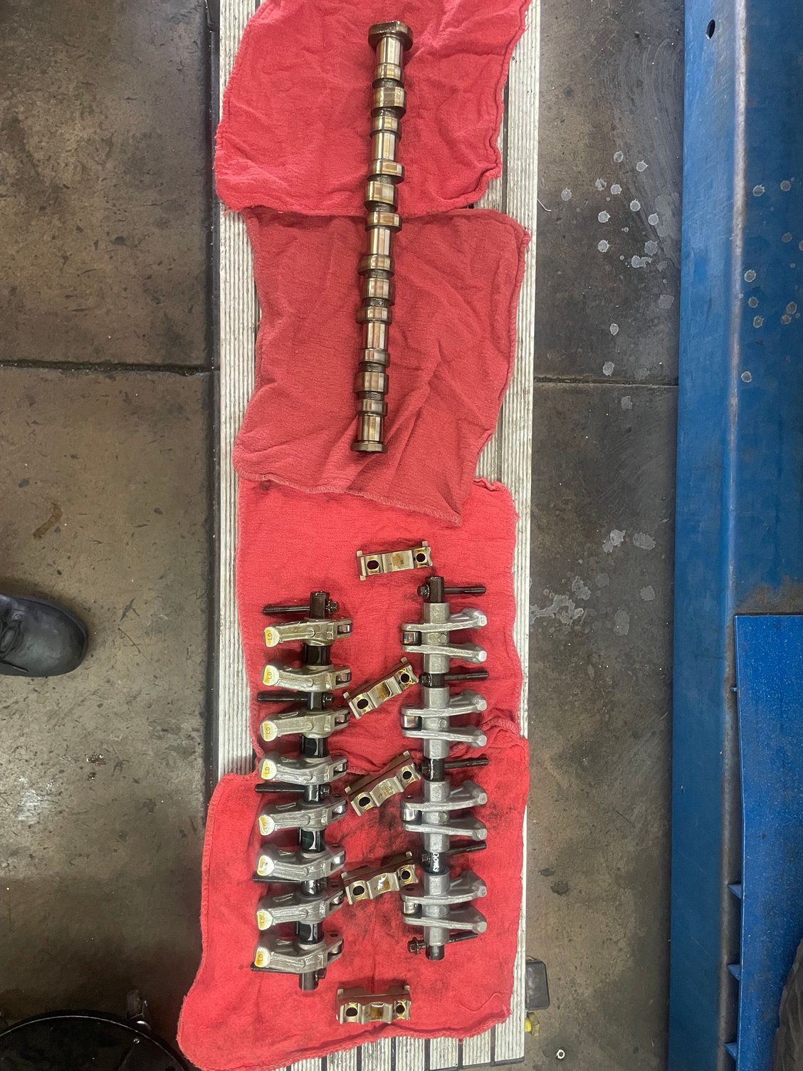

Satisfied with the cam lobe clearance, I remembered I had to swap my new rocker arms onto the rocker shafts. I hadn't done that before, but it wasn't too hard to figure out how it goes. Here is the stock cam with the rockers laid out:

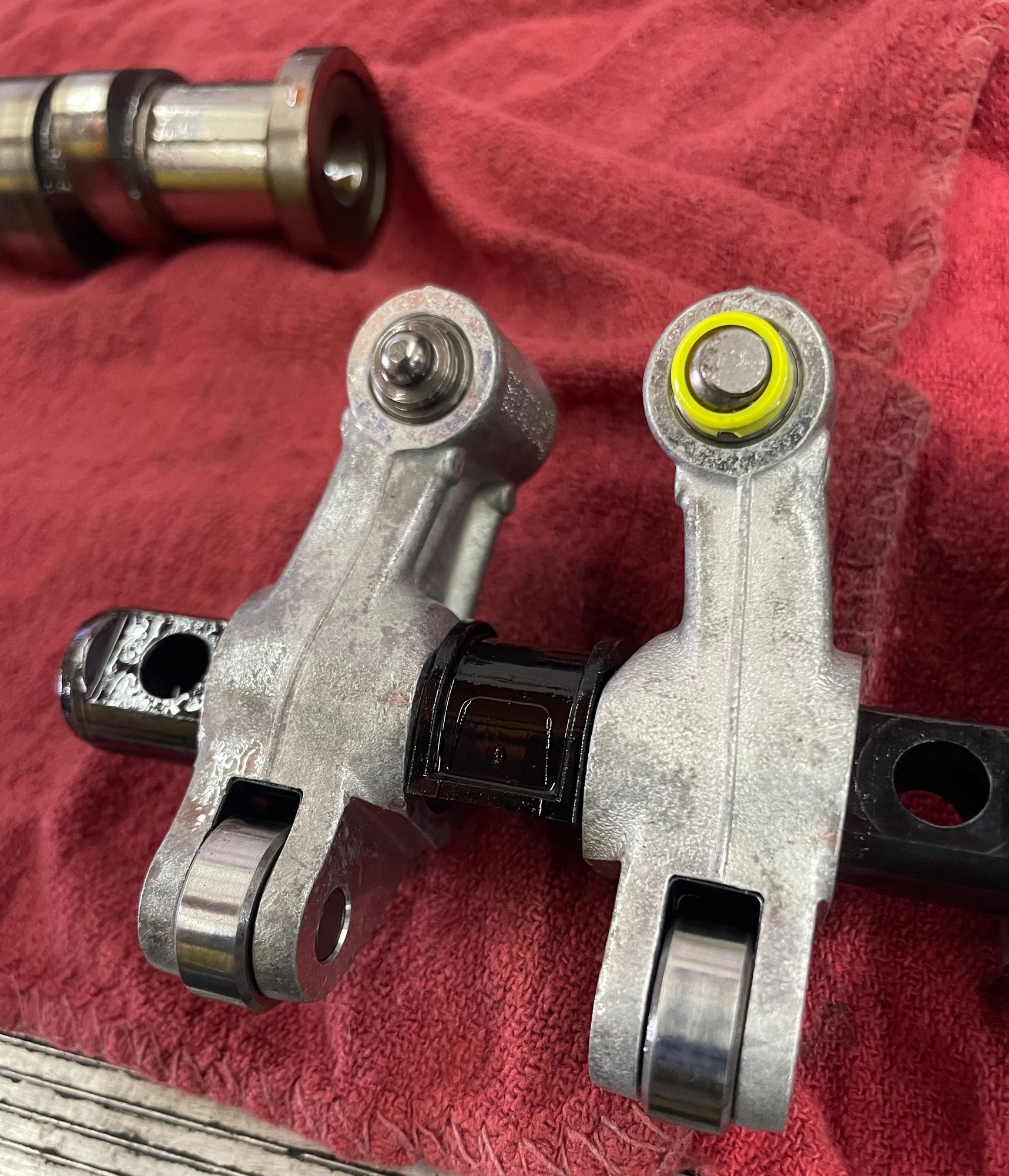

Since the intake side has more parts, I swapped the rockers on that shaft first, using assembly lube to pre-lube everything. With all the rockers on the shaft, I flipped it over to lube the lash adjusters and got an unexpected and unhappy surprise:
One of my brand new, genuine MINI rockers was missing the cap that contacts the top of the valve! As each rocker was in its own bag, I checked all the bags for the bright yellow piece but all bags were empty. I check the floor around me. Nothing. So really? My brand new rocker was bagged without the cap? I thought I heard they were removable, so I thought I could transfer one from one of the old rockers to my new rocker. I got it off pretty easily but could not get it to fit the new rocker. As I need to drive the car today, the option of pushing the car outside and dealing with FCP Euro was not an option I was going to choose. I simply took a rocker that was already on the engine and used it. My OCD didn't like that much but pushing the car outside and waiting to complete this job some other time was not going to work for me today.

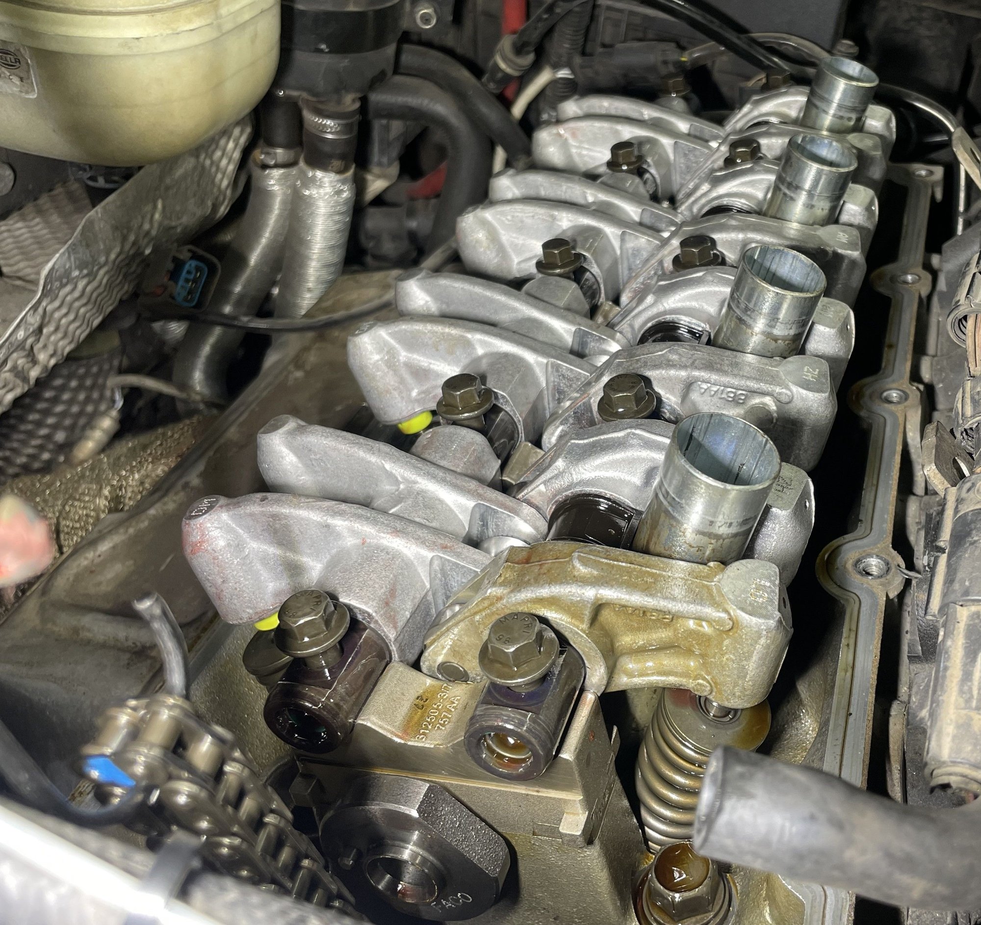

I got the exhaust rockers swapped and now my engine can truly begin going back together. Setting the intake rocker shaft on the head is something of a pain. Patience and a gentle touch finally got all the rockers where they belong. Exhaust side was much easier. Time to carefully tighten the rocker shaft bolts.
