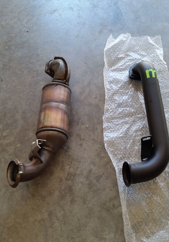

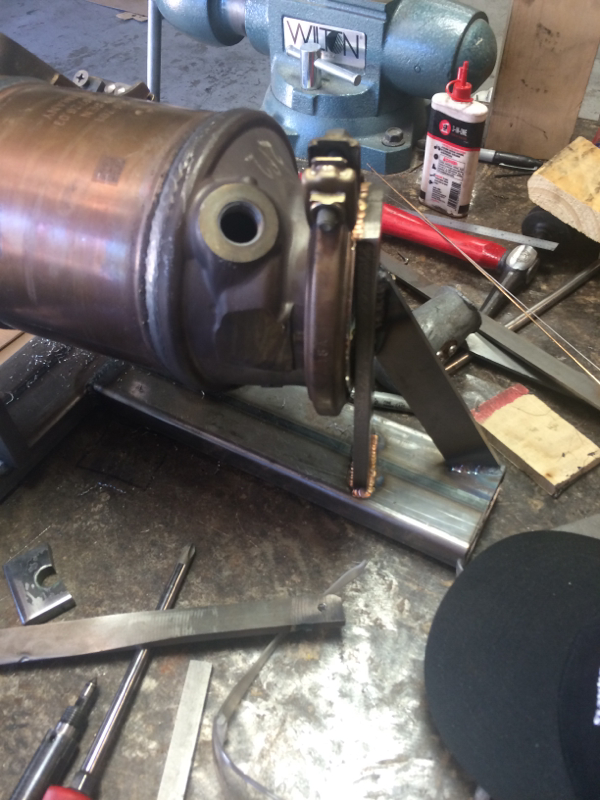

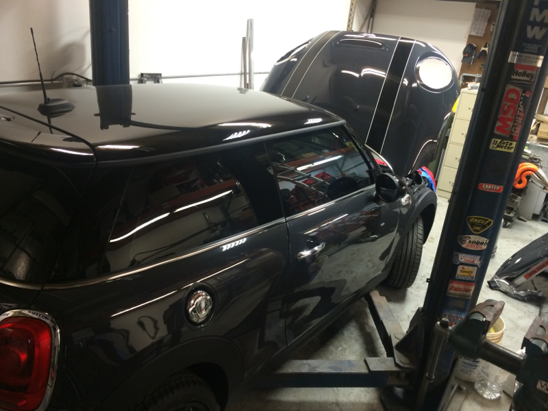

I have built the N14/N18 Ceramic Coated DP, but now I'm moving to the new F56 2.0 and the BMW s63 (M5 M6 X5)
The F56 DP is no joke and has many challenges compared to others. I expect really nice, top end gains and I have unique second O2 bung, that won't trip a CEL light for no cat. The Jig is coming around nicely. I should have a finished F56 DP in 2 weeks
Here are few pix and one of my R56 DP with the Extreme Ceramic coating that handles up to 2300F
Mario

Thank you, I gained about 20whp with my DP. Of course the more mods before (especially a Tume) you have prior to the DP, the more the HP gain will be. I used to short shift at 5200rpm because the car didn't make power after that, but now the needle races to 6500

I'm hoping my unique second bung will not let the car trigger the CEL. It has worked on the M5/M6 and 6cyl turbo BMW motors

No, but it's welded into the pipe

It's going to take some time. I'm thinking 3-5hours, it's the heat shields that are the biggest pain

The turbo flange side is 4.66"
