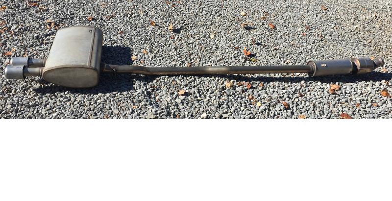

OK. To make sure we're all on the same page. Remus offered two variations of their F56 exhaust. The first option was a "full system" that bolted to the downpipe. You could get it two ways (with a straight pipe or with a silencer). This was supposed to be a "no cut option." The other system didn't include this front pipe at all and required cutting the stock system a distance in front of the stock muffler. I went with the first system, calling it a "full system" preferring not to have to cut anything and I call the second system that required cutting a "cat back system."
However, as a result of the difference between US and Euro spec designs my supposedly "no cut" system required that I cut the first roughly 6" off the stock system and clamp it to the Remus front pipe so that it would mate with the US downpipe. The Remus front pipe was designed to use an adapter (a 6" straight pipe which they supplied for Euro systems) so the install was simple, but it has rendered my stock system unusable in any future scenario.
