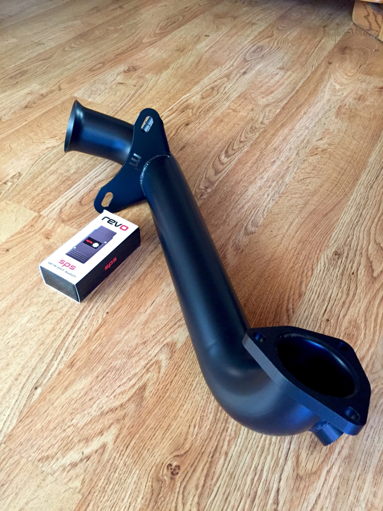

This is for the 2014+ Mini, but I do the the R56 ones and they are completely bolt on.
Send me an email at MarioPalza@gmail.com
Mario
mQubed Motorsport, Manic Tuning Dealer

i think i was the 2nd guy to get the M-Qubed DP installed february of last year. i dont' recall having any heatshield issues. the only issue i had was that the DP hangers didn't line up with the stock hanger location and was pressing against the subframe. the shop (helix) ended up bending the hangers just enough to get it to fit, but just barely. truth is, i think it did mis-align my exhaust as it hangers lower than stock now. it hasn't cause any negative issues so i haven't really pushed hard to fix it. if i were to fix it, i'd have the hangers cut and redone to match the OEM.
besides that, fitment was fine. sorry to hear about this bud. i'm attaching a picture of my DP if there is any way you can compare it.
