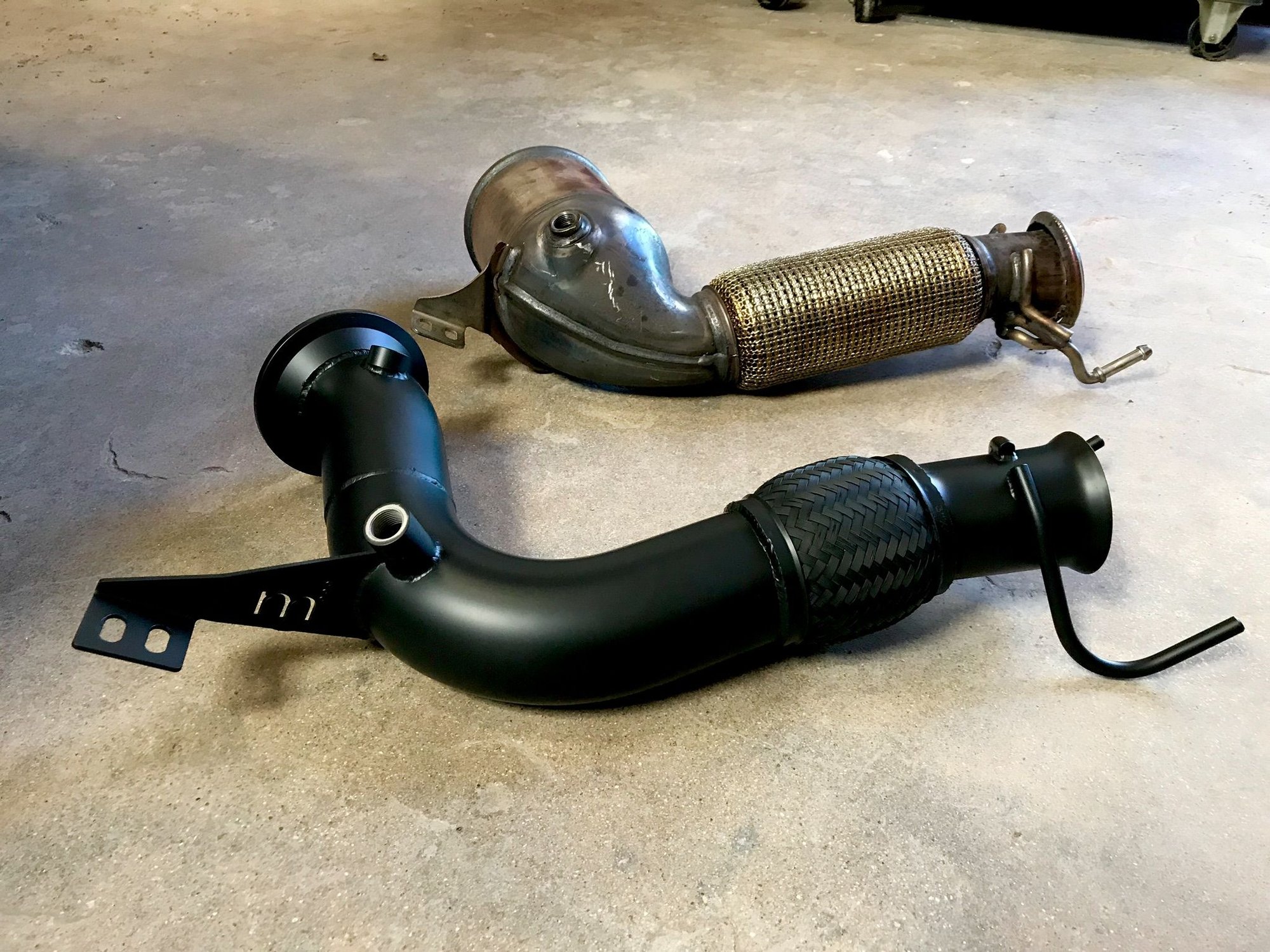

F series B46/48 Downpipe
My F 2.0 series DP's It's 2.75" 304 16G Stainless Steel, ported flange, mandrel bend piping and OEM size flare. Keeping and even 2.75 keeps the low end drivability, but makes great top end power and no freeway drone. The Extreme Ceramic can handle up to 2300F, important since the turbo reaches over 1600F+. Ceramic also protects for customers living, with salted winter roads
The flange is ported to align with factory turbos and to match the new growing market of hybrid turbos.
Expect about a 15-20% increase in sound, with a deep done.
They are $749 in the Extreme black finish and $649 in bare stainless finish, this includes tax and shipping in the US.
Also, my new batch of downpipes now have built in downpipes frequency bung on the second O2 sensor, so it won't trigger a non- cat CEL

So I got mine earlier this week and installed it yesterday. I didn't feel comfortable putting my Mini on my jack stands so ended up having to use ramps. That made things a bit difficult due to the height.
I ran into this issue too of not being able to drop the DP correctly due to it hitting the bottom heat shield. I spent several hours just banging away best I could and got it enough that I was able to finally put the clamp onto the turbo and DP, then with enough pressure from the clamp, it finally sat flush (or so I think, It's on there really solid as hell now...). Once I tried to put the top of the heat shield back on, only the top 3 torx bolts matched up correctly (BTW, that circular thing that goes into a slot on the right side is TERRIBLE!). I was able to get the one very deep down on the right side after using a crowbar to push in and my hand to pull forward, but the other 2 (from the quoted pic) has a huge gap. I had to leave those off for now. After I connected everything back up, I started it up and it sounded weird. Not sure if it's an exhaust leak or if the top heat shield is rattling or the DP is rattling around on the bottom one.
All together, it took me 5 hours to install. 2 of those hours was awkwardly trying to hammer the bottom heat shield. I drove around for a bit and definitely feel extra torque in it with just mid mode. It sounds great and deep, and since I run with my JCW exhaust valve open all the time, the pops are insanely loud. I probably have to drive around with the exhaust valve closed now. Maybe lol
I'm too tired from yesterday but next Saturday my friend is going to help me figure out what I'm hearing and hopefully we are able to fix it, as well as to help me fine tune a little.

After less than 30 miles, CEL came on. "Catless downpipe detected." :(
