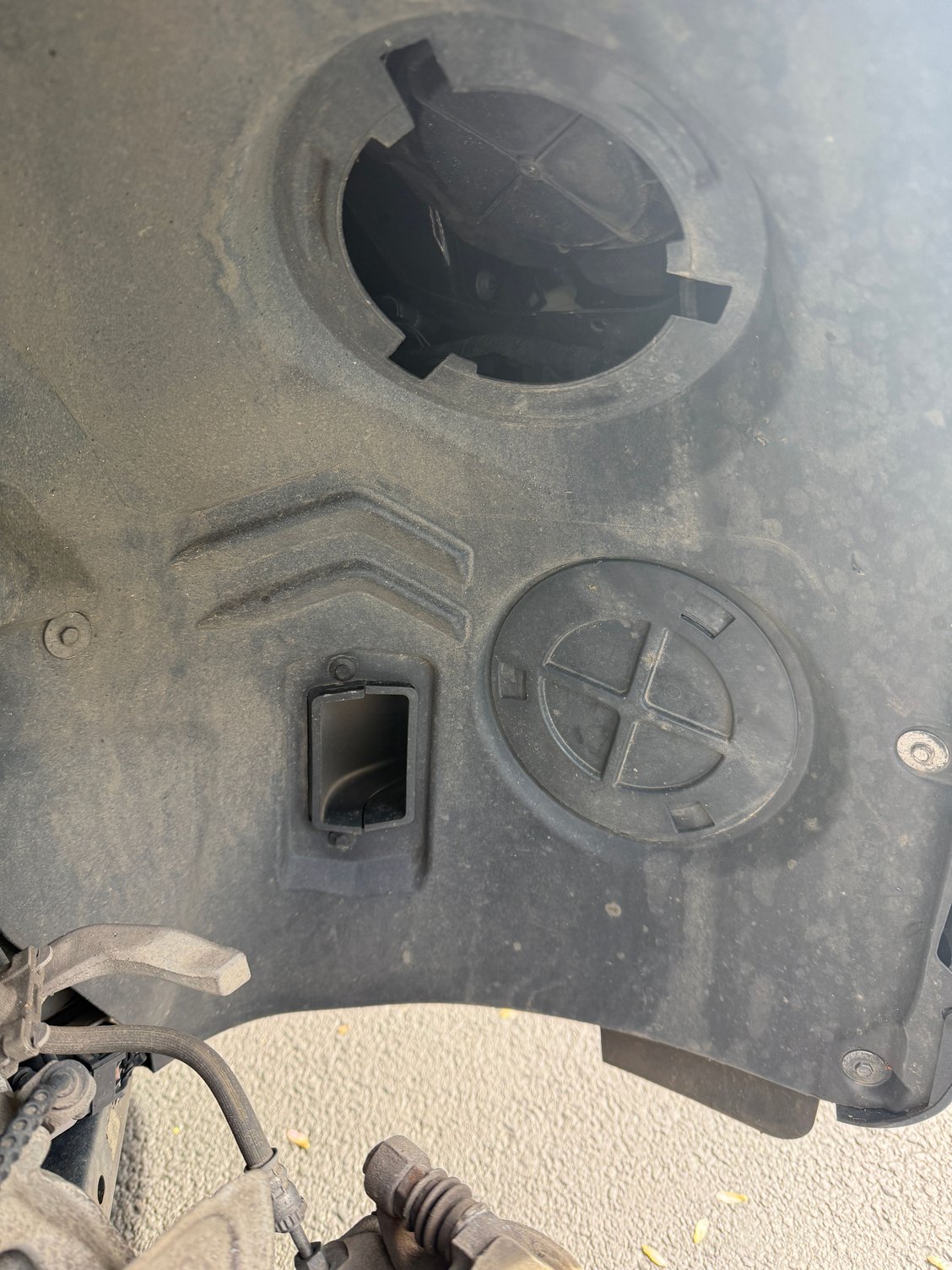

Inside look of liner before anything done. Note, missing cover. Lost it at dealer at one point, but could never find another one....
Screw/washers that will need to be removed. 10 of them total, 6 inside wheel well, 4 under air dam.

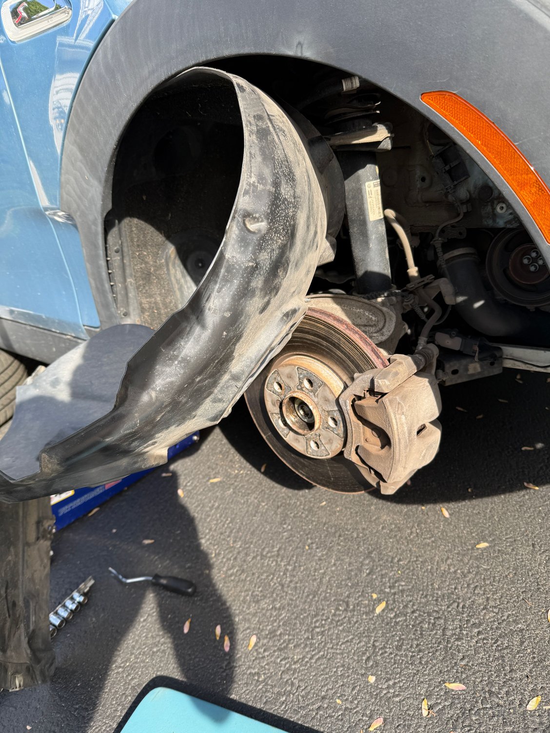

Inner liner partially pulled away.
Washer Bottle now completely exposed.
