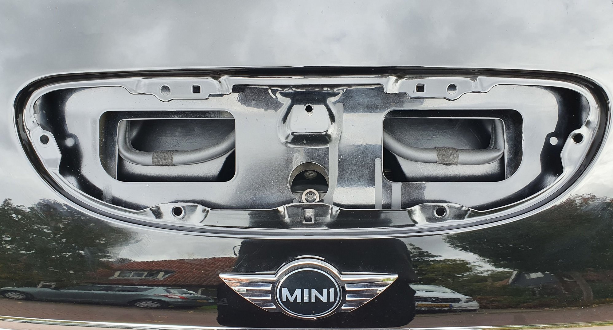

Not sure if Eventuri change their hood scoop design yet. I had Eventuri installed before and the part of the intake under the scoop did not match the opening of the hood scoop. I've contacted Eventuri regarding this issue over several emails. They were very friendly and willing to help, but sadly they didn't even know the F56 and F54 had a different position hood scoop. I was going to retro fit it buy cutting the opening of the intake to fit the scoop, but I had to give up and return the intake due to the awkward position. Be sure to contact them and ask about it before purchasing. Maybe they have a new one specifically for F54.
The two small openings were too close together and too far back. When you close the hood, they don't match the openings on the hood. Both are only covered about 50%

I like the Eventuri design, but want to make sure it fits the Pre-LCI Clubman. Every indication I've seen, is that it doesn't. If the Pre-LCI kit is just for the F54, then maybe. However, there is a difference in the F54 vs F55-57.
My recommendation is add the Pre-LCI MAF tube to the LCI kit, since the Hood/scoop location is the same.

" I received an email from the Eventuri Sales Administrator. She indicated that the technical department is aware of the problem and is fixing the plastic CAI ducting.
The problem has been resolved for the CF version, and unfortunately, it will take 6-8 weeks for the solution to be implemented for the plastic version." That was back in June.
We have one in stock from the older design. I will see what they can do. Hang tight.

I had the same issue with my plastic CAI from Eventuri for my Pre-LCI F54.
After contacting them, I was informed that a solution was found for the problem and they sent me a replacement manifold. I am still not impressed with the fitment, but it is much better than before.
