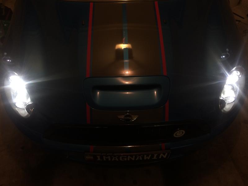

OK update on a pre-2009 install
Everything went perfect! After hooking them up, I poked around in NCSexpert for a while and ended up with this combo that didn't flicker and also didn't throw a bulb-out warning:
1. Added $522 VO for Xenons
2. FRM Module Changes:
Disables auto-leveling
AUTO_LWR_ENABLE
nicht_aktiv
Also disables auto-leveling
DYNAM_LWR_ENABLE
nicht_aktiv
Changes headlight pinout
PWM_FL_BEI_BIXENON
wert_01
wert_01
I still have no clue why MINI claims they only work on 2009+ vehicles. I'll post here if anything stops working or is giving me problems, but at the moment, I don't see any issues.

Bonus pictures
Attached Thumbnails oem xenon 25w retrofit kit??-img_4403.jpg   oem xenon 25w retrofit kit??-img_4406.jpg   oem xenon 25w retrofit kit??-img_4397.jpg
