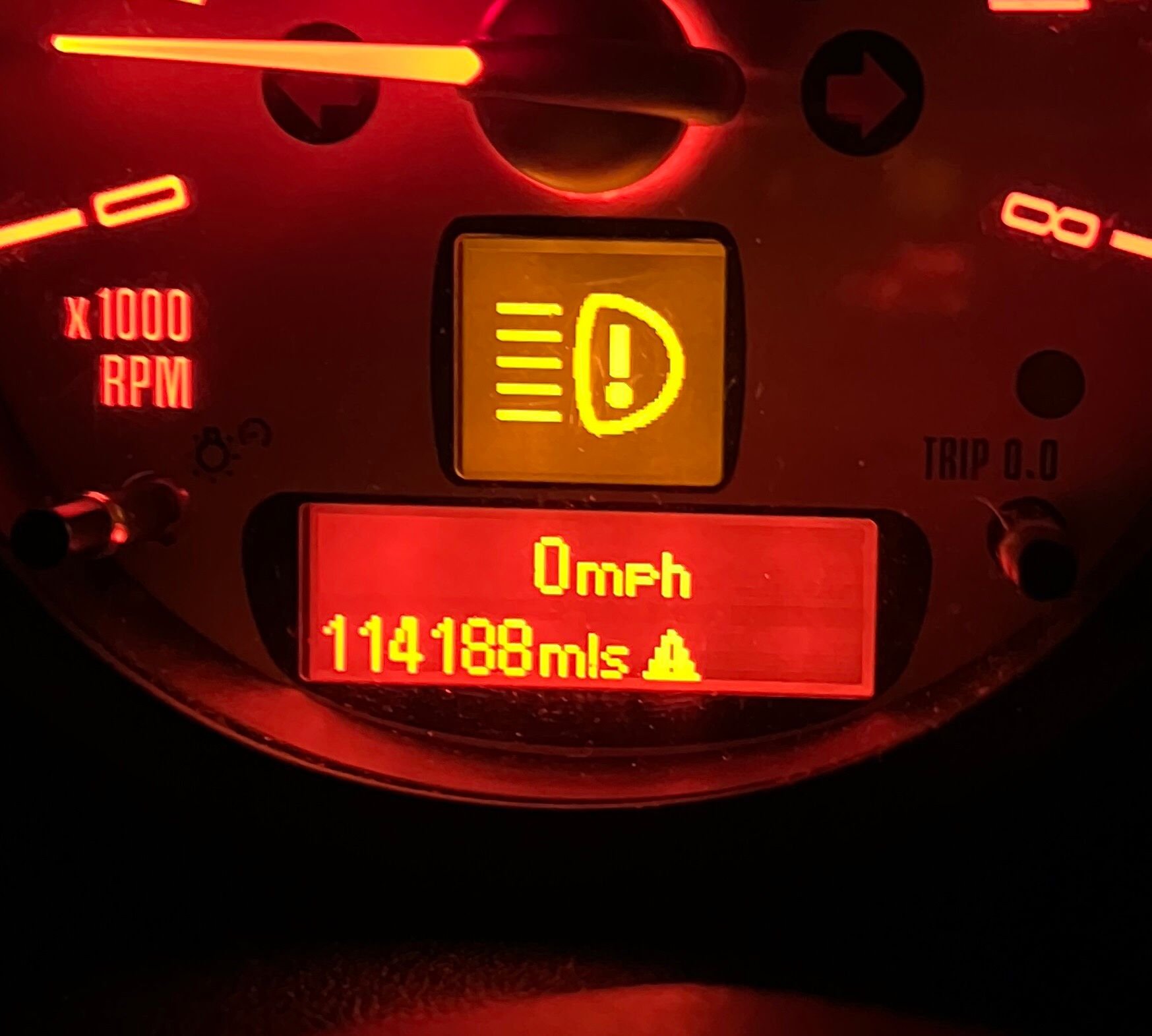

I love that this decade-old thread keeps on giving. I installed the 25w kit in my 2013 R56 yesterday, after gleaning most of the info I needed from this thread. They look great! I did have to code PWM_AL to wert_01 in order to fix strobing (which was super easy using BimmerCode and OBDLink CX, in under 10 minutes).
One thing I haven’t found an answer to is how to get rid of the headlight exclamation point error icon that appears in the console for ~30 seconds after starting the car. Any ideas? Thanks to all who contributed to this forum!
<UPDATE> Never mind, I figured it out! Had to set "Check Control Notification High/Low Beam" to "active" using Bimmercode. Now the warning icon is gone.
