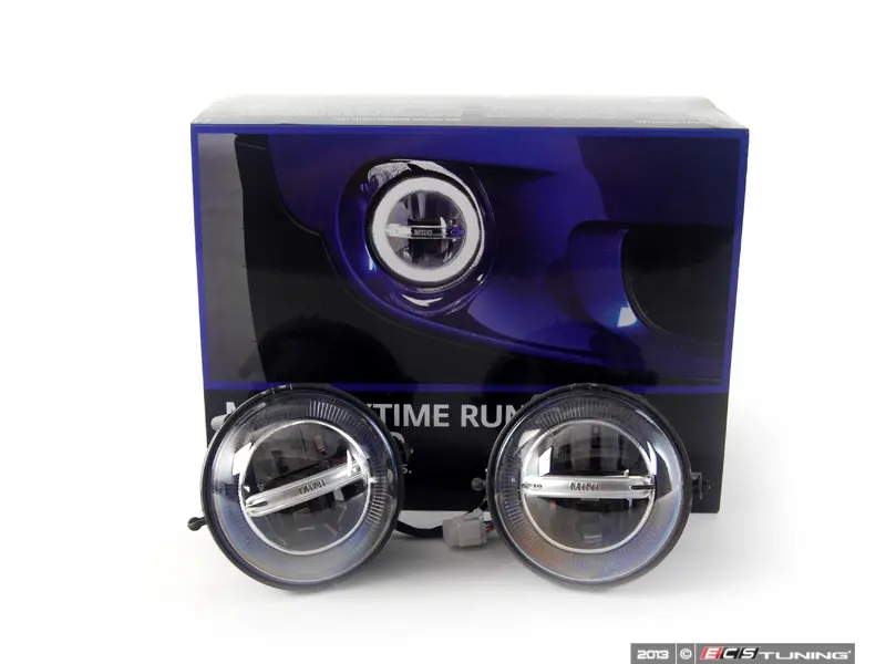

After installing the retrofit kit (loving it btw) I now want to replace the DRL's and fogs to LED's that match in color to the xenon retrofit kit.
anyone done that? got any recommendations?
Old May 19, 2020 | 07:53 AM
  #207
Posts: 36,705
Likes: 2,535
These are the closest:
https://www.ecstuning.com/b-genuine-...d/63122338554/
https://www.ecstuning.com/News/MINI_...dlights_24113/ closer to white/blue with the super white H8 bulbs in non led in ziza linked.
