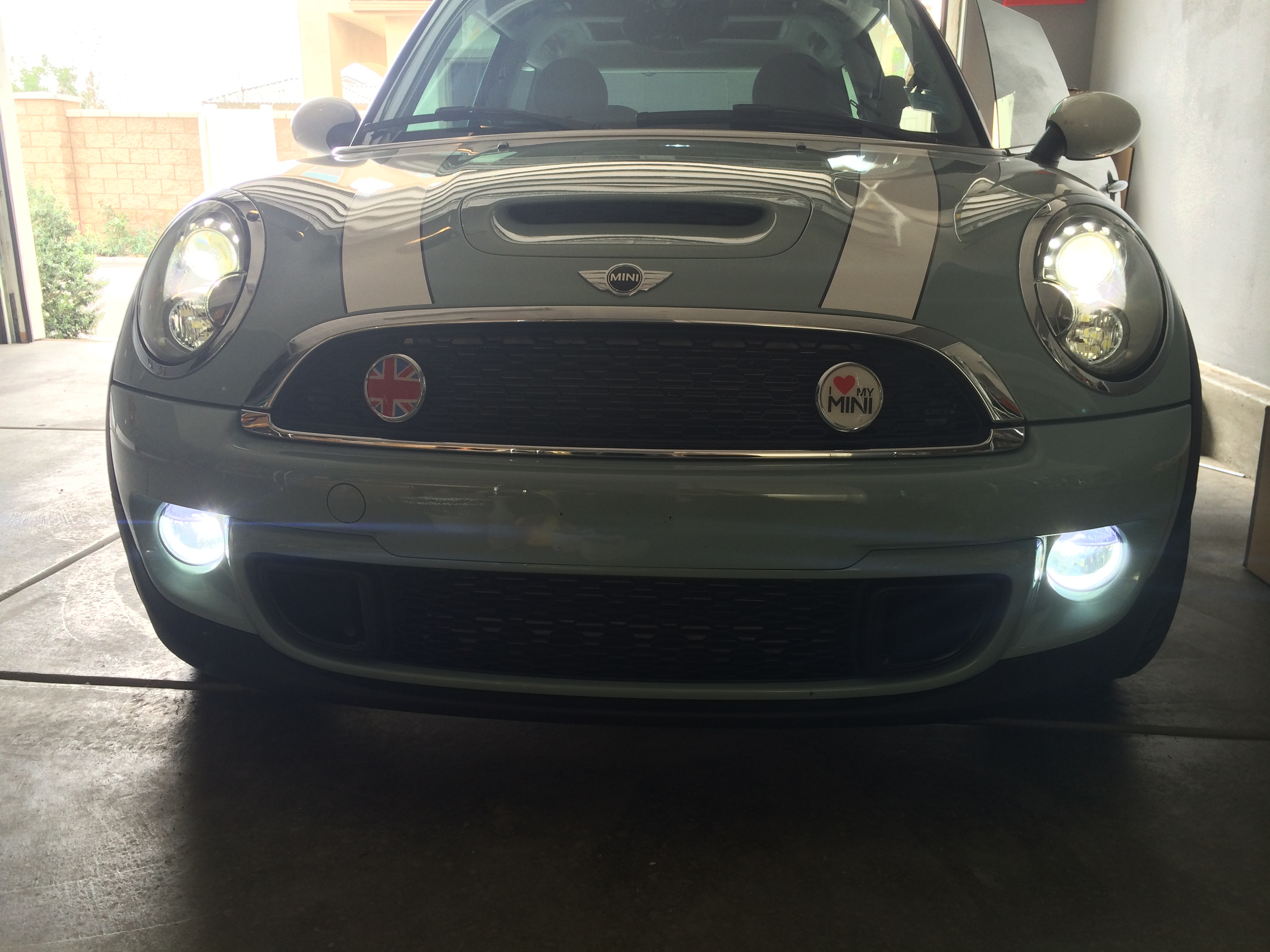

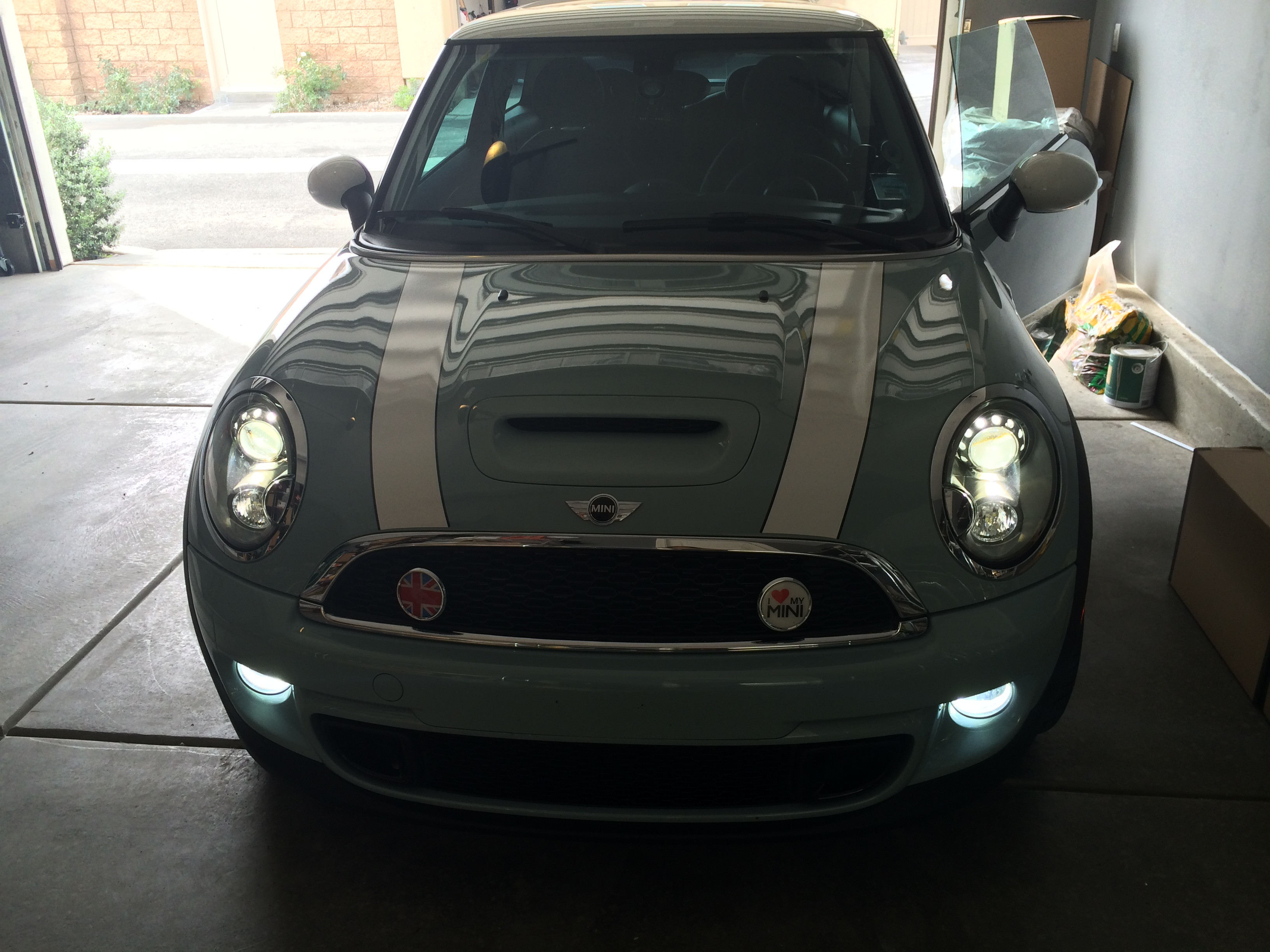

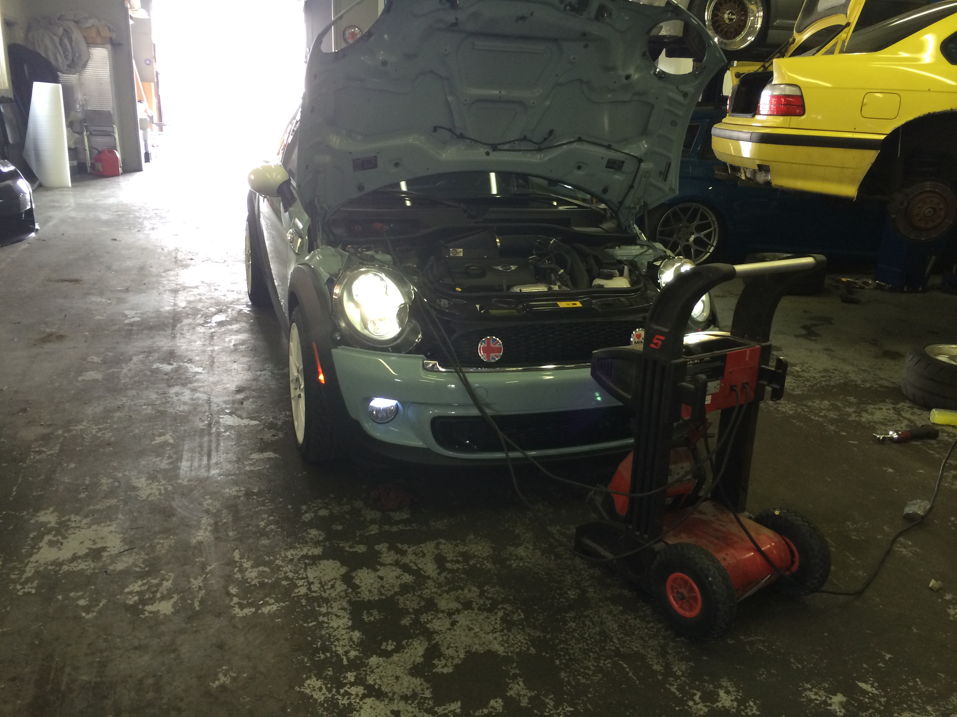

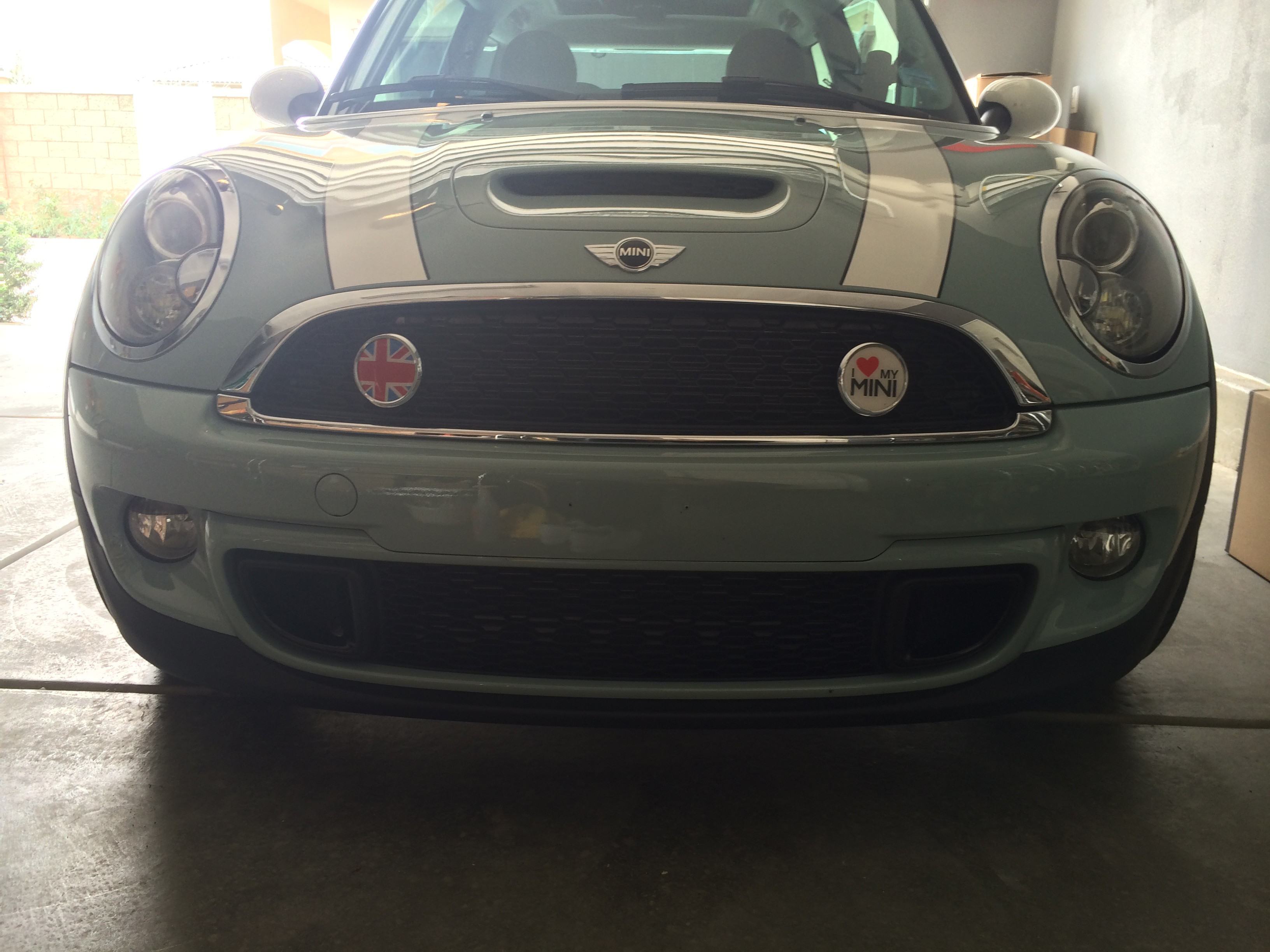

I successfully installed these new 25w headlights on my 2013 r56S this weekend (only 10 minutes) and they are now strobing. I've been trying to find a dealership here in Southern California to code my car and they are trying to charge me $150+ PER HOUR for coding ??? Seriously ridiculous. They claim it takes ATLEAST an hour just to code for these headlights and even up to 3 hours. What a joke. Now I can't drive my car and it's just going to sit in the garage until I find a solution.
Old Mar 11, 2014 | 03:18 PM
  #100
8eMINI's Avatar
8eMINI
Joined: May 2013
Posts: 117
From: SoCal
Success!
Things have improved since my post yesterday. A local shop here in SoCal was able to program the lights in.. wait for it.. only 5 minutes take that Mini dealerships! Here are some photos:
Last photo: success after only 5 mins of coding at the shop
I installed the headlights myself this weekend and they were really easy. Removed 4 screws on each headlight, unplugged, and then plugged in the new ones and replaced the 4 screws. PM me if you are in SoCal for the shop to get coding done for these headlights. You will definitely NOT pay the prices the dealer is trying to charge. I am a super happy camper
