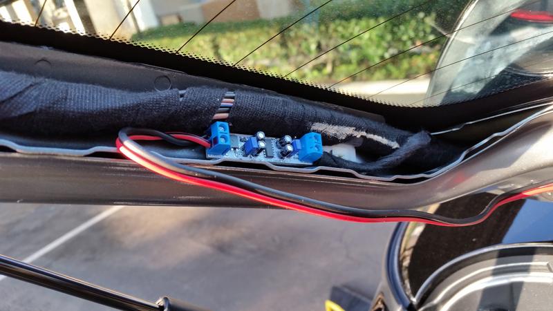

Old Dec 6, 2014 | 05:28 PM
  #89
Systemlord's Avatar
Systemlord
Joined: Mar 2013
Posts: 3,428
Likes: 37
From: Mission Viejo, CA
I installed my brake pulsar kit today that I got a Way Motor Works, very easy. Sorry for the fuzzy picture.
Attached Thumbnails 3rd. Brake light pulsar-20141206_152102-1-.jpg   3rd. Brake light pulsar-20141206_152039-1-.jpg
