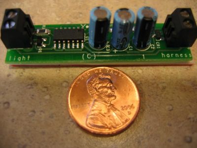

Installed Gomini's 3rd brake light pulsar yesterday. The install was a little tricky, as the '07 does not have as much room near the light as the R53. I had to extend the brake light wires, so that I could mount the circuit board on the left side of the hatch. Results are pretty amazing...I drove down to the beach yesterday, and every time I hit the brakes, the cars behind me really reacted faster than they otherwise would have. The look on many of the driver's faces behind me was priceless. I highly recommend this mod!

Sounds like a very desireable add on to have, I will have to get one. Did you get the 4 or the 6 pulse one? was there enough room to snap the cover back on properly?. I noticed that the instructions were for the 02-06 Mini.

I got the 4 pulse version...installation was a little tricky. There is not room on the R56 to mount the circuit board next to the light. I extended the supply cable, and mounted it below the screw on the left side of the rear hatch. Took about 30 minutes total.

I like your idea of spliceing and relocating the unit in the left side of the trunk door. I pulled off the trim to check it out. Still pretty tight in there with the existing harness. however the right side door channel has plenty of room in it, (no existing wiring harness). I looked on Ebay and found a compatable unit with adjustable flash rate that will fit, for quite less money. Again thanks for the info.

If possible could you take a picture of your placement, have it on order and would like to prep the wiring(extend), so when it arrives its a quick connection....thanks............

I went for the 4 only because it makes the pulse on every brake depression, so if you were in a stop and go situation, it's just a lot of pulsing... I thought the shorter the pulse burst, the better. But I doubt there's any real functional difference!

Just installed the 6 Pulsar on our 06 MCS. The installation was very easy and only took about 45 minutes since I was a bit more cautious than usual. After the first ops check, I was amazed at the effectiveness of the Pulsar--WOW. I look forward to the reaction of the tailgaters. This is one accessory that I should have installed on day one. Ordered the Pulsar on Friday and received it yesterday--great service and customer support by Gominigo.

Moss Mini has the brake light pulser with a delay for stop and go traffic. There is a 15 second delay between activations. I have ordered it and will let you know how the install and operation go.

I received the Pulser from Moss Mini. I have a question: On the 2007, there are two wires coming out of the 3rd brake light unit, a brown one and a yellow one. Does anyone know which goes where? Thanks!

The 06 has a brown and yellow wire extending from the wiring harness. It then attaches via a plug to a socket on the light. From that socket two wires are soldered to the light itself-one black-one red. The pulsar atached to the red and black wires. Don't know if this helps you on the 07.
