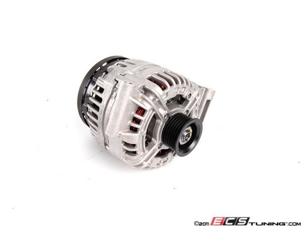

+1 Had this happen also, then the battery light came on and everything stating going dim. Just had a new battery. The brushes on the alternator were worn down with over 200K, but I did not want to risk changing them to have the bearing fail or something else with that mileage , so I just replace the whole alt.
If you go to the 110 A from the stock valeo unit , you will need the power cable ( 12427534704 ) and the short cable ( 12517534705 ) for the conversion. Pick up three 07130770522 new bolts also.
