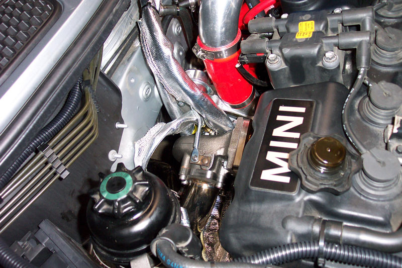

Why yes......yes I did! Take lots of photos that is, as for the write-up, not yet....I still am digging the nasties out from under my fingernails!!
I will post everything once I get the car to a point where I have solid data....right now as it sits, I am getting oil into the intake & have yet to diagnose it completely....I have spoken to Jeff today, however I was not in front of the mini to go over the routing of the crankcase breather. We feel that might be the issue, as he mentioned they had a similar case on their car. I will know better tomorrow when Jeff can work with me in front of the vehicle to verify all the routing is correct.
I attached 2 pix showing the turbo, since i havent found any available. This should show you all where the turbo actually sits. The 1st pic is the test fitment & reclocking of the compressor side of the turbo for final fitment. The 2nd pic is of the final assembly of the GT3071 with Downpipe & the oil feed line & coolant send & rx lines.
If you take notice to the firewall....it's required to remove the black plastic housing & heatshields in order to fit the turbo. There is actually a lot of room once that is all removed.
