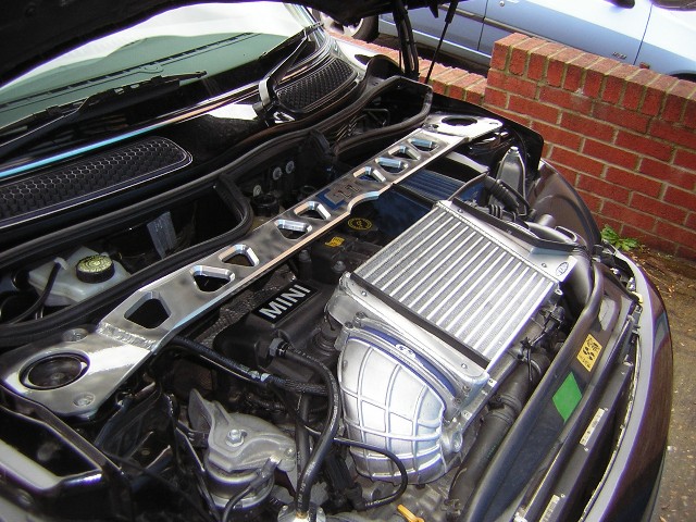

Here's a couple of pics. I'd really love to keep the strut brace if I can work around it as it really has made so much difference to the cars handling that you wouldnt believe! Let me know what you think. I can get different angles if required down the back tomorrow if you require?

I dont see anything that is different from that view than the lefthand drive cars. The big thing would be your DP clearance. I am not sure if your steering linkage would be in the way then. Its hard to see in there, and you really will be removing all of the back black plastic. As long as the steering linkage isnt in the way you should be good. As for the strut brace, the intake pipe may clear it underneath, but if not, you may need to alter that pipe. Check out the pix in my gallery to see how high it runs. There is a little bit of play with the pipe depending how u clock the compressor side of the turbo.

Thats good thinking and i'll check in the light but i'm confident that the power steering shouldnt be too much of a problem.
Have just been look at a few peoples installs and looks defiantly possible to work around the strut brace but just need to watch for engine movement so probably somenew engine mounts.
Thanks for having a look, always good to get a second set of eyes to have a quick look for anything I might have missed.
