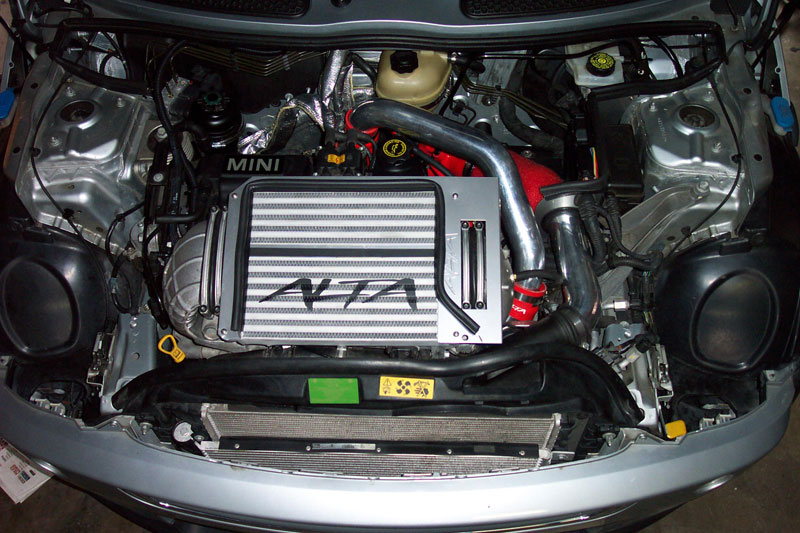

Yeah the sig kind of sums it up......but here is a pic of the final install.....

Congrats on the clean looking install.
I'm not sure why you guys are gettin excited about the stock ecu handling all this. Our cars are equipped with a 2.5 bar map sensor which maxes out at around 22 psi. And as long as you are running the stock injectors the computer should work fine. However when you turn the boost up higher than 22psi then you run into problems...

Also another question... Why are you upgrading your fuel pump? You have stock pistons correct? The factory pump isn't as weak as everyone thinks. And if you plan on running alot of boost say good by to your pistons.

Spillman is right....I am running my stock fuel pump...and we all know I am at the 340 WHP mark....so...WHOOOOPIE!
