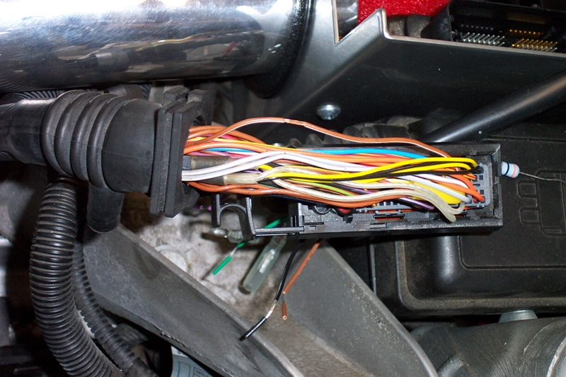

So when you say you have the apexi cut into the ecu what do you mean? How does the apexi AFC install? Also when you installed the kit for the stock settings, as far as the injectors and boost levels go (around 16-17psi right?) how much tuning work did you do afterwards? Did you need to take it to a dyno or anything at that point? I have about got my car back and will be ready to install soon but the only problem is that im no master tuner and the nearest dyno and people that could help with tuning are about an hour away.

Ok, the Apexi has if I remember correctly 7 wires that tap into the stock ECU wiring harness. You need to take the caps off the wire harness plugs & tap into the correct wires there for power, ground, knock sensor, pressure, fuel trim & maybe another...not hard to do, but still nerve racking at best. The only way you can really tap into the harness is to remove the covers. Then its much eaiser to see what to tap into & there is more wire to tap.
Actually I didn't do the stock install. I started out in that direction, but decided to go for broke. I did very little intial testing with it stock. It will run fine with the stock injectors and on 16 psi boost on the stock ecu. You wont really need a tune at that point, but it would deff would help it. If you decided to tune it, then you would need a way to alter the fuel mapping. The Apexi has proven to be pretty decent at allowing you to get a tune that can keep the car's A/F in check thus producing more power.
In your case, I would just shoot for the stock setup to start. I would though plan on getting it to a dyno to have the A/F ratio checked at least. That way you will know where the car is sitting on fuel/air. The setup I went with is basically Alta's stage 2 but using the APexi instead of their ECU since it isnt available yet.

Here is a pic of the wireharness with the top off & one wire stripped back. I used an exacto knife to do the cut. You then either solder your wire to that, or use the splicers that come with the apexi.
