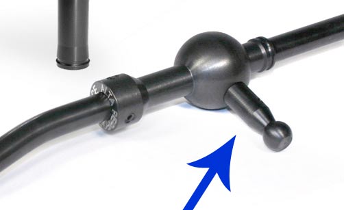

Well i have a Alta Short shifter and the piece that's between the big pivot ball and the plastic thing broke.
I was putting the car into reverse and then all of the sudden, i had absolutely no response. When i lifter off the boot of the shifter, there was the piece hanging freely. So right now i only have 2 gears... 3rd and 4th. I called Alta but they are away at SEMA. (What bad timing) Well i hope they will replace the piece. The threading looks a little warped and i hope that's all i need.
Has anyone had the same problem?

from what I remember when I installed mine, that piece is interchangable (so they can keep the same body and change the ball and socket pieces for the different model years). Unless you completely stripped the threads in the "big ball" (I think it is threaded) you should be able to put a new piece and motor away. Hopefully ALTA can hook you up. It has been my experience that they will stand behind their products.
Good Luck and keep us posted.

you dont need thast piece that broke off.
all it is is a damper, (or reverse, i dont remember)the car will still go into all the gearsd without that connected, you just have to be careful where your putting the gearshift. (no speedshifting)
I think it is necessary to go into reverse, 1st, 2nd, 5th and 6th. otherwise you have control over only one cable.
As for replacing the part, i forgot if i need to jack up the car to screw the piece back in. can i do it from inside the car? its been over a year since i put the thing in. The large plastic piece is in the way but i might be able to work around it.
Thanks for the tip about getting the piece from were i bought it. It might work. i just have to find the site i bought it from.
And last, i think after i get everything working, i may take that bottom cover off if its not a problem.
Thanks everyone

the one main cable controls all the forward gears.
i was playing around with it the last time i put a SS in my new car.
