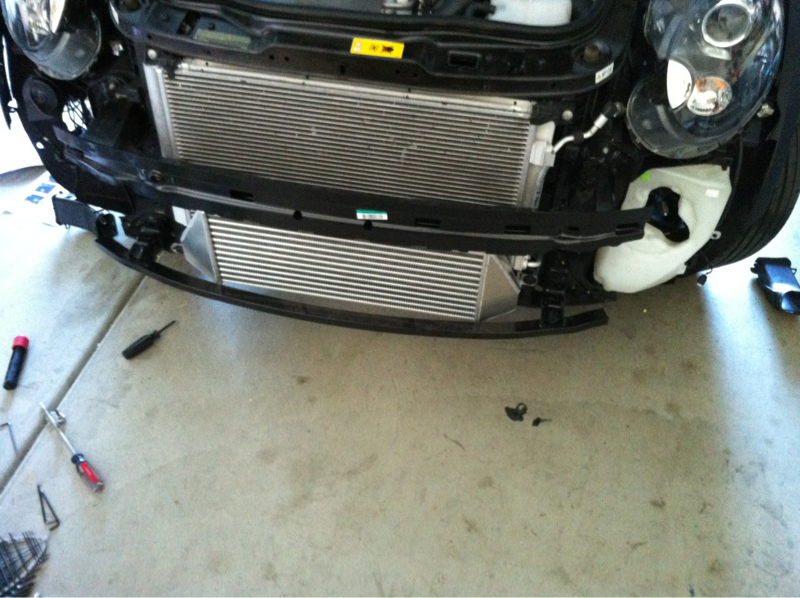

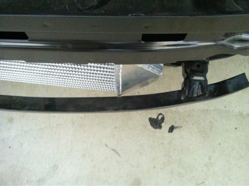

So over the past few weekends I have been in the process of installing my mods onto my 2012 JCW R58. All the engine bay stuff (Hot Side Boost Tube, Forge BoV, DoS Intake, BSH Oil CC, Seafoam Fogger, Boost taps, etc...) is completed. This past weekend I decided to dive into installing my Forge Intercooler. I lifted the car and started the process of removing the front bumper. Since my R58 has the same N14 engine as my R55 did, I assumed all would be the same. Once I got the bumper removed, I found something that didn't exist on my R55. A lower crash bar.
This lower bar is welded into place and as far as I can tell cannot be removed.
Here are some more shots:
The intercooler I have is the Forge R56 unit. I only used it for about 8000 miles on my R55 before I stripped it off when I sold the car. I guess I assumed it would fit considering the front end is identical. But I guess not. On the Forge Motorsport page they do list the R58 intercooler as a separate part number, but it looks identical to the R56 unit. Also the instruction manual for the R58 unit does not show images of this bar on their demo car, which is a euro spec MINI. Which makes me believe this is only on US cars or only on JCW cars.
I also have concerns, as I have found several vendors selling the R56 unit as compatible to the R58, and even listing the R58 JCW as compatible. I called Forge USA up and asked about it and they mentioned that they do not have a R58 intercooler for the US market available yet. So I am wondering if any of the vendors actually have installed an intercooler (Forge or otherwise) into a R58 or specifically a JCW R58. Maybe the Euro spec R58s do not have that lower crash bar, or maybe it is only on JCWs. I don't know. But I image that since the Forge won't fit, than the Helix and Alta will not as well. I can't really say about the Tyrolsport, but looking at their install instructions, their demo car does not have the lower brace and there is no mention of it in the directions. With theirs you need to remove the entire front bumper support, but even with that removed I can't say it would clear the lower crash bar.
If anyone has thoughts on this or if I missed some glaring thing with the install, please let me know. I forwarded these photos to Forge and will do so to the other manufacturers.
Thanks,
-Z

I have an N18....had to remove the crash bumper.

Originally Posted by zcast
Nice! So how was that removed? I couldn't see where I could remove it. Is it welded to the bumper support above it and comes off with it? Is that the Forge or Helix?
It's the forge unit, you can see how close it is to the lower crash bar...can probably barely squeeze a quarter in between.
The lower one and upper crash bar all remove as one piece. I believe there are about 11-12 bolts holding it to the front end to the car...it all comes off as one piece.
The tricky part is putting it back on because the holes might not line up because of the weight of the engine bringing it down a tad. Easily done by just having a second hand push up a bit while you line up all the bolts and tighten it down.

No problem! And yea that bumper is a pain, especially with the brake ducts...well at least for the S R58s it is haha.
It's actually the bolts that are marked with red paint that have to be removed...you can see them in the pictures you uploaded.
I don't have a Bentley manual....just jumped in and went for it. Next time you have it apart you'll see it's actually fairly straight forward.....but that Bentley Manual wouldn't hurt to have haha.

You def didn't try to install it correctly. I've already installed 6 of the Forge intercoolers on the R58's and R56's with that extra crash bar and they all fit perfect. You need to unbolt the bumper as that extra crash bar is part of the bumper and then install the intercooler on the mounts and hoses, then just bolt the bumper back on. You'll have just a little more than a 1/4 inch clearance between the crash bar and the intercooler.

Well I got it installed today. There was no way to just loosen the bolts and fit the Forge in there (as far as I could tell), so I just removed the entire bumper support. 6 - Front facing nuts, 2 - rear facing nuts, and 2 - T20 screws. The rear nut on the drivers side up by the brake duct was a ***** to get to with the wheel on. I image removing the wheel and the inner fender well would have made it not so painful. Getting them all to line up when reinstalling also was a chore but not too bad.
I could probably fit a piece a dental floss between the FMIC and the lower crash bar, but that's all. It's pretty tight for sure.
Glad it is finally on.

Yea, there is definitely more room on the passenger side than on the drivers side. My gap on the drivers side looks identical to photo NewCooperFanatic posted earlier. It looks like you might have an extra 1/8" or so play than I do. I tried sucking the IC up as far as it goes, but it basically rests on the radiator so there isn't anymore room to go. Either way, it does fit. I assume the Helix would be the same?
