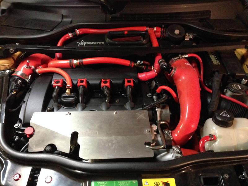

This is my latest set up; 2 cans and 3 vents from CC. Vacuum on cans under idle/light accel then one way cut off valve under boost but vacuum from turbo inlet.

This covers a naturally aspirated application, but the mini's I see are turbo charged, and by plugging the dirty side (the upper left corner in the picture) there is no evacuation taking place at idle, deceleration, or non-boost cruising. And then all the oil containing blow by vapors are traveling backwards, out the clean, or fresh side. So, the picture shows clean and dirty running to one can....this will stop most oil ingestion, but at the sacrifice of engine life as almost all the damaging combustion by-products are left in the crankcase to accumulate.
As in the Arrington paper (again, great paper), they do a great job of describing what each component of a PCV system does, and how it does it....so defeating evacuation defeats the constant removal of the compounds entering (the paper misses sulfuric acid and water vapor as well as abrasive carbon and soot particles) before they have a chance to settle and accumulate in the crankcase.
So, the proper fix for the mini as shown in the picture, is a dual valve can system that has dual outlets and checkvalves flowing away from the can inline on these outlets. The upper right corner would go to the inlet (center) of a dual valve can as this shows:
(this is a turbo 4 cylinder for the new Caddy ATS, but same principal:
And a picture of a dual valve can showing the center inlet, outer outlets:
So, upper left corner from valve cover to center of can (inlet of foul/dirty vapors), one outlet with checkvalve flowing away from can to prevent any boost from entering the intake manifold when turbo builds boost and intake manifold vacuum is no longer present to provide evacuation, second outlet with checkvalve flowing away from the can connects to a barb you install right at the turbo inlet. You want to be as close as possible to realize the greatest suction while in boost to continue evacuating, the OEM connection is close enough for the turbo side of the fresh/clean side, the ATS diagram shows that GM has a suction port/circuit already built into the turbo inlet side for this. Then on the clean.fresh side (other end of valve cover that runs to the turbo intake tube) needs to be replaced with a clean side separator that will then connect to a -8 3/8" NPT barb you add just downstream from the MAF sensor. This maintains MAF metered air so your short term fuel trims don't go nuts trying to adapt to the un-metered air the open vented cans allow, and it maintains a closed emissions compliant system in all 49 States (CA needs CARB cert components). So, here is how the final solution will flow:
Filtered, MAF metered fresh air enters the new barb added to the cold air intake tube, runs through the clean side separator (replaces oil fill cap, and the valve cover factory barb is capped) where any oil back flow is caught, this travels through the crankcase flushing the dirty/foul vapors out and replaces them with clean filtered air. The outgoing foul/dirty vapors then run through the oil separating can, and then depending on if in boost, or if non-boost, either the intake manifold vacuum evacuates/sucks then scrubbed vapors out into the intake manifold directly, or if in-boost, the turbo inlet suction pulls it in that path where it is then pushed into the intake manifold where it can pass the valves with no compounds to coke, or bake onto the valves.

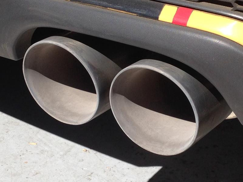

Actually JPMM my coolant temp stays at 180 all day long. I drive it on the street too. The tune accomplished this.
Although I do not have an oil temp gauge whereas in the past on other cars I did, the only thing that caused elevated oil temps was stop and go traffic. ON the track the temps stayed close to normal freeway driving temps
My A/F is actually slightly rich 14.3 idle 12.5 load and 10.9 WOT.
I burn next to no oil; 1/4 qt every 3-4k.
