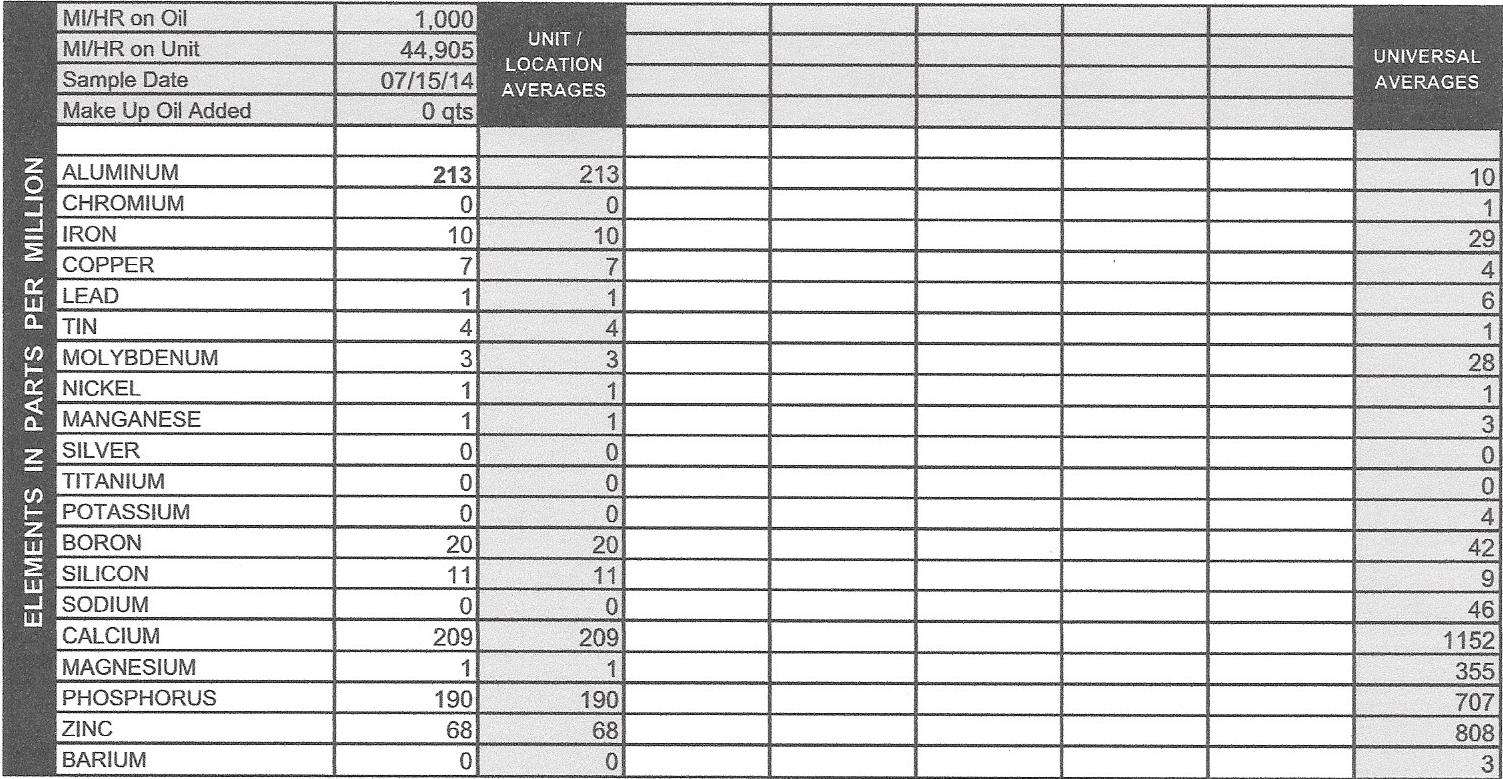

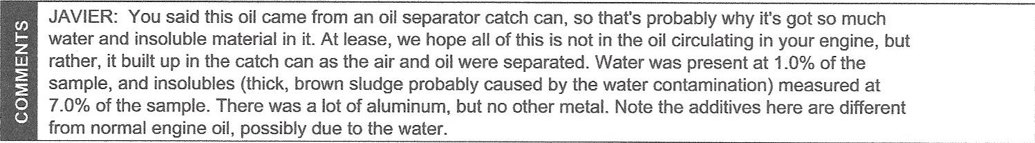

The average can sold to address these issues is only between 15-30% effective, so most everything still passes through them no matter what you see caught.
As far as composition of what is trapped, with one of the few that do catch most of the contaminants, Water is always in greater amount when temps fall below 45* F. Look at your exhaust on a cold morning start-up...lots of water vapor is expelled out the exhaust (extreme pressure and temps during the combustion process release it from the air charge). Next, unburnt fuel due to cold start enrichment and the fact that gasoline does not burn very efficiently as a whole. The soot and carbon particles fall from suspension first, and that is where you see engine oil discolor. Sulfuric acid forms during the process and it and water generally turn to steam and condense under the cam/valve covers and inside the engine block with most accumulating in the oil. Fuel condenses as well into the oil and is the most difficult to separate where water will settle to the bottom of the oil pan as it sits (it first emulsifies with the oil to make the creamy colored gunk).
So, there is no real way to separate and remove them effectively once they mix....but if evacuated (removed) as soon as they enter, then they for the most part are not an issue.
Here is a sample analyzed by Blackstone Labs of what the RX systems catch:

Now the aluminum content is way high due to the sulfuric acid working on the aluminum engine and the can itself as it sits in it.
Hope this helped.

Thanks for posting, this is good information. For comparative as more people track the performance of their OCC. A lot of Aluminum, Sitting in the Aluminum canister eating away at it I have to agree.I would like to compare with a Stainless canister.

Stainless I suspect wont show this as it resist's corrosion, but it hurts nothing as this is in the separator. It also is not visible corrosion as we have cut them apart after 10 plus years and you can't see the effects the acid has, but a lab test will show.

How come there is no sulfur in the lab report?
