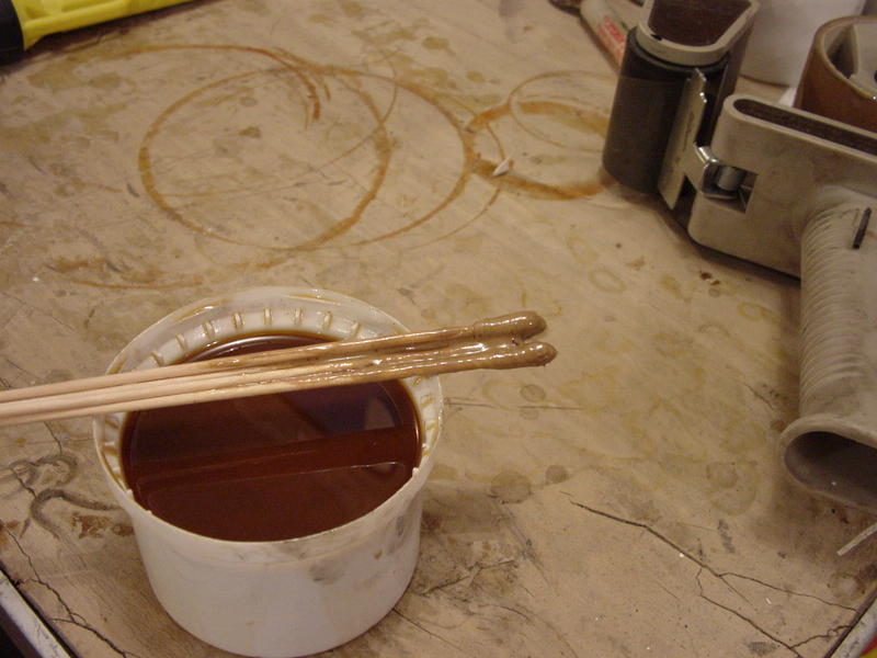

heres some photos of what is caught in a catch can
WOW
Attached Thumbnails Does a 2009 JCW Need a Oil Catch Can?-dsc00513.jpg   Does a 2009 JCW Need a Oil Catch Can?-dsc00510.jpg   Does a 2009 JCW Need a Oil Catch Can?-dsc00511.jpg

From the looks of the last set of pictures, this will definately be the first addition to my 2012 MCS that will be arriving within a couple of weeks! That looks pretty nasty. My concern is having any warranty issues, do you think I would be better off asking the service manager at my MINI dealer, or just removing it whenever it has to go in for service?
