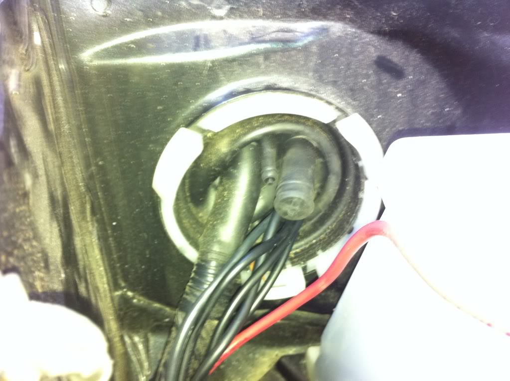

First I took the tank and mounted it, then ran tube and wires through one of the rubber grommets in the floor board.

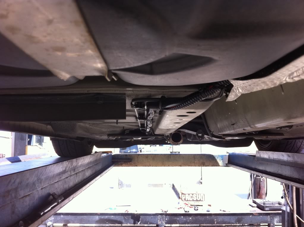

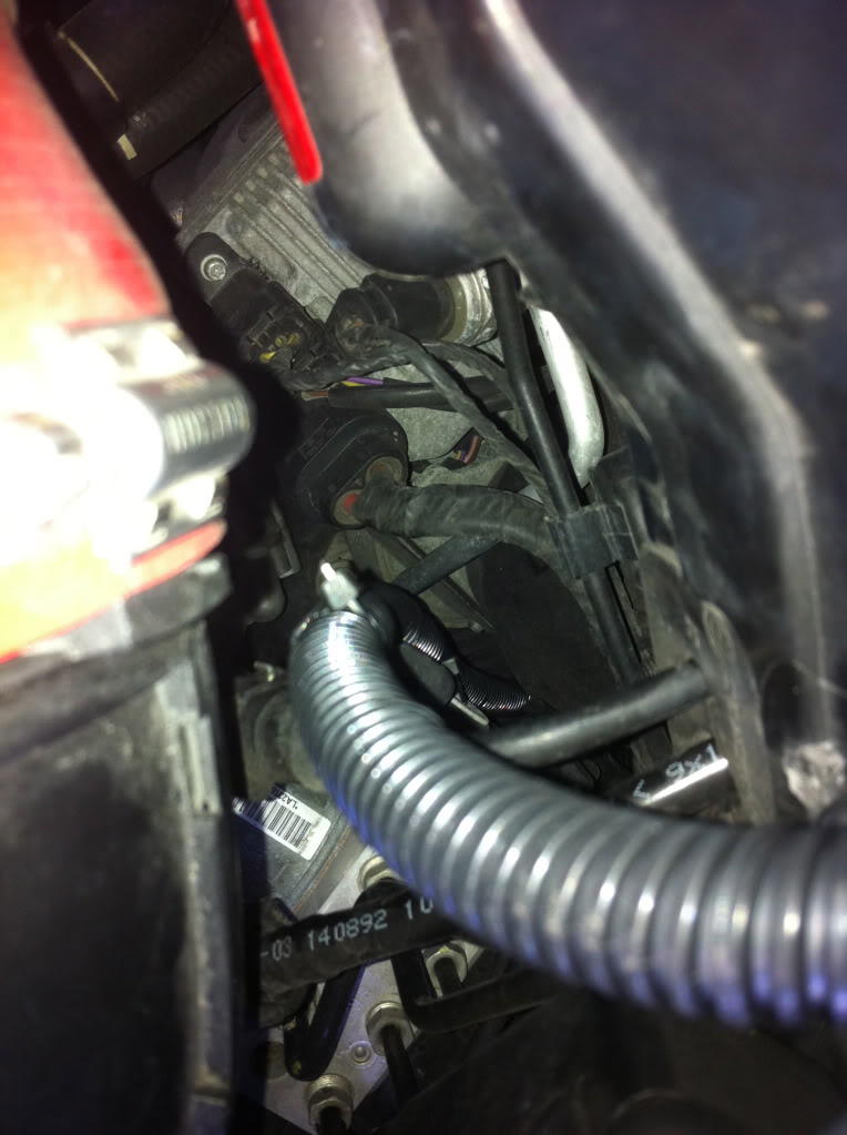

I ran the hose and wires along the break lines into the engine bay.

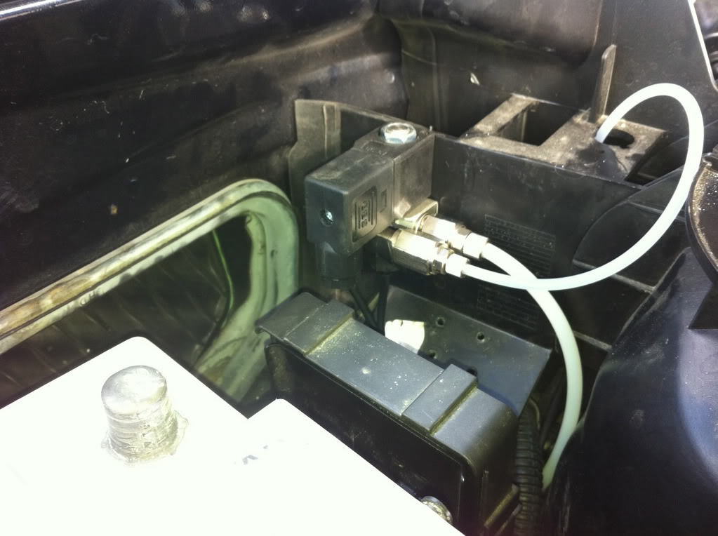

From there I put it into the area in-between the engine and fire wall. Connecting the FAV next to the battery.

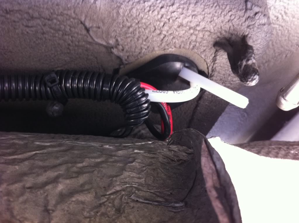

I ran the bundle of wires under the battery into the rubber grommet on the passenger side.

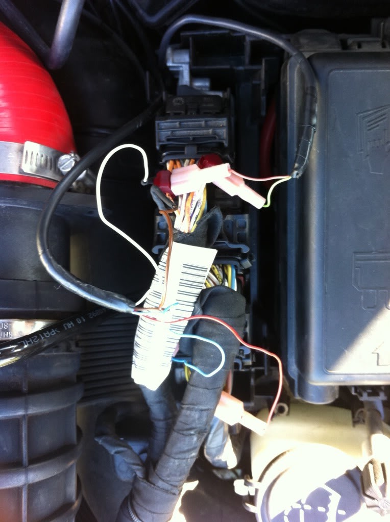

I brought it in to Rush Motorsport's in San Diego to have the ECU wired. They tapped and soldered the wires.

I cleaned up all the wiring and this is the final result.
