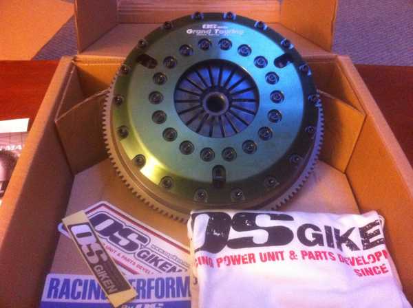

3. 12/14/12- OS Giken GT clutch arrived in the mail. It came with some stickers and a t-shirt.

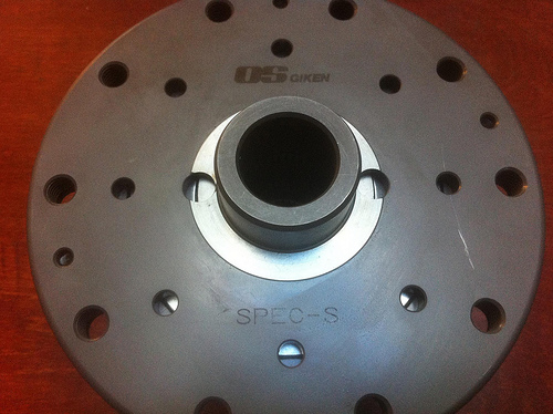

The first item I have for you in the OS Giken LSD
I dont have much to say about this. I purchased it off of OS's reputation. It seems like a solid product.

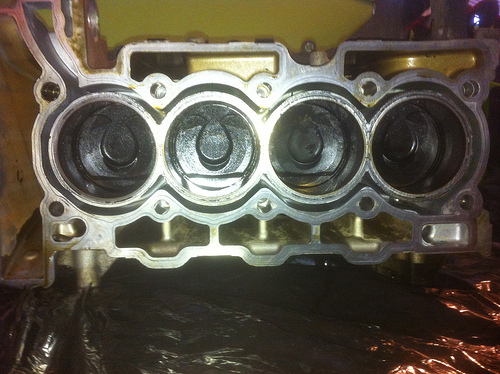

Photo of my block before I dropped it off.

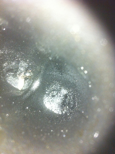

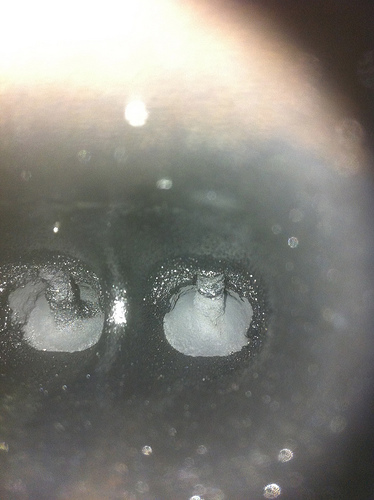

And of course the obligatory carbon buildup post. First the dirtiest one and then the cleanest one. A thing I did notice was that the one that was most dirty is directly above the PVC inlet on the manifold. Don't mind the fly not sure how he got there.
Now the good/bad news. I dropped everything off as the machine shop and since its the holiday season...... its going to take at least 3 weeks. So I wont have much for you till I get my turbo back from G-Pop.

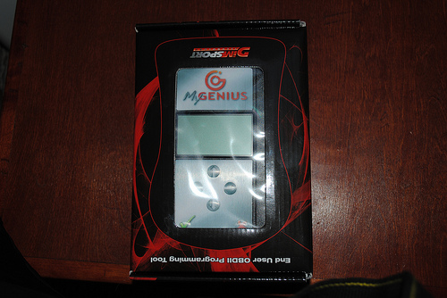

8. 12/24/12- Received the DimSport MyGenius flash tool today.

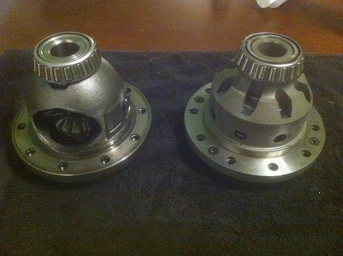

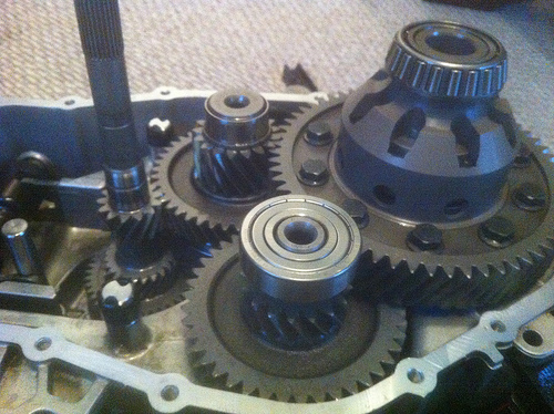

11. 12/27/12- Installed the LSD in the transmission.
Stock dif / LDS
The gear on the right is reverse and those three little T shaped things were all the trouble.
Here is the inside of the gearbox, the spot on the bottom left is where reverse gear was supposed to stay, total pain.
One more of it all put back together.

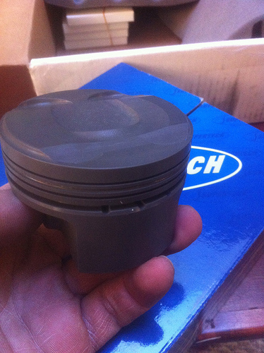

12. 12/28/12- Pistons arrived today, CP 77.5mm 10.5:1CR
They are a little bit heavier than the Supertech ones but the quality is much much higher. The weight would be expected with a denser alloy. Other than that I am very happy with them.

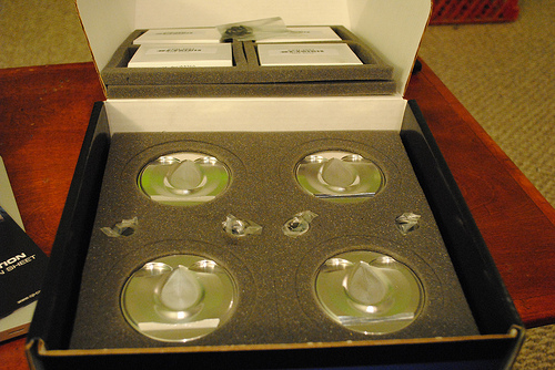

15. 1/9/13- Got my turbo back!
Old
New
Compressor
Exhaust

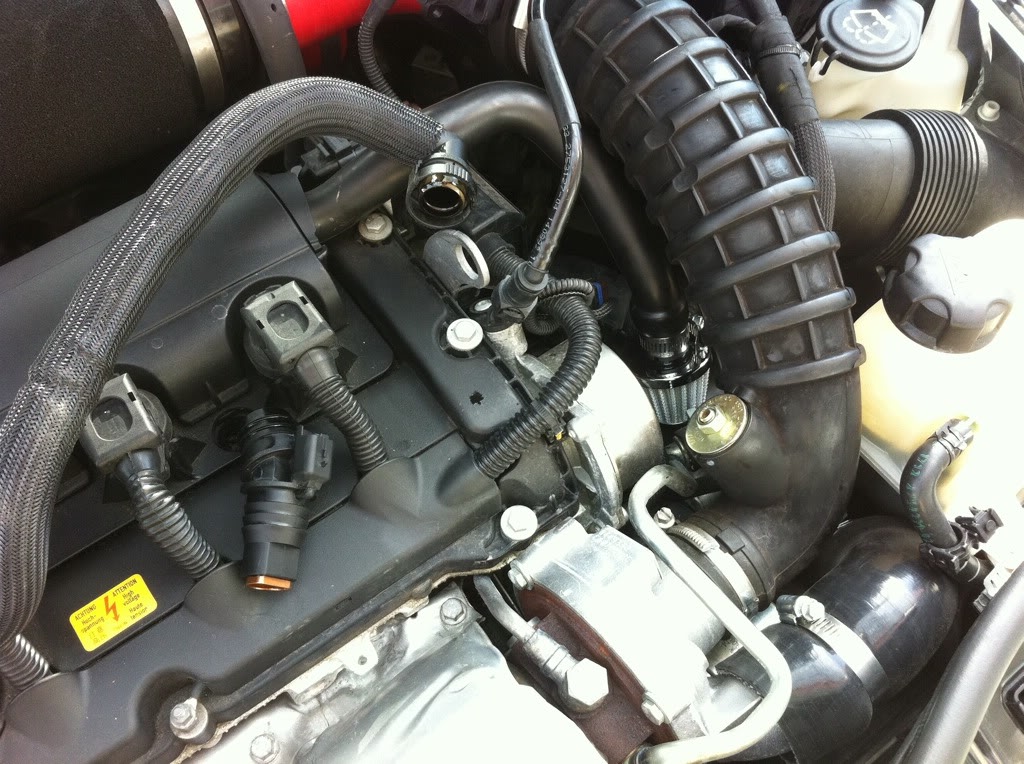

So after reading through all the posts about catch cans and our PVC system I decided this is the easiest thing to do.
First I contacted CZAR and purchased to of the caps from him.
First I removed to hose from the crankcase to the manifold and put in the two caps.
Then I went to the local auto parts store and picked up a neoprene plug and a breather filter (to substitute till I can get an appropriate length hose to run under the car)
This is the end result.
I have a longer hose now so all the crankcase gasses are come out of the front port and away into the air under the car. Not in my motor at all. If any of you are worried that this may cause positive pressure in your valve cover or crank case it wont. This is why,

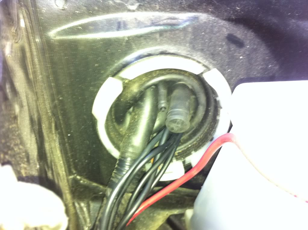

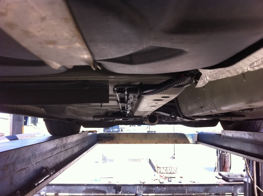

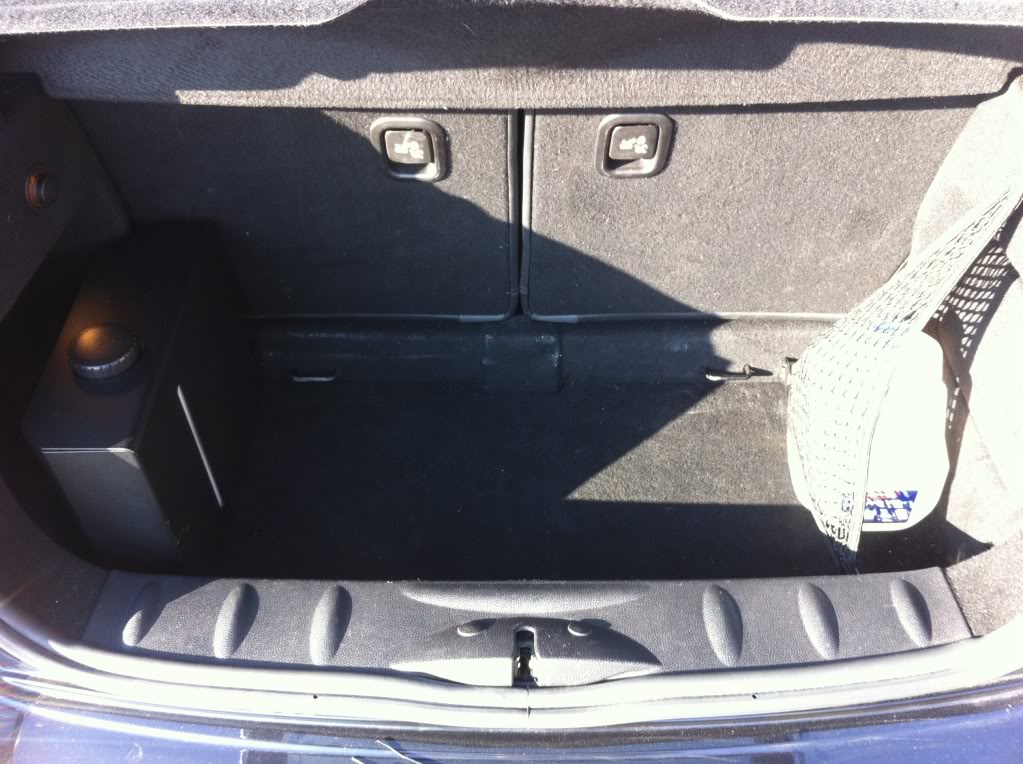

First I took the tank and mounted it, then ran tube and wires through one of the rubber grommets in the floor board.
Then trimmed the vent hose and put shielding around the bundle.
I ran the hose and wires along the break lines into the engine bay.

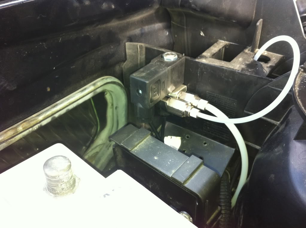

From there I put it into the area in-between the engine and fire wall. Connecting the FAV next to the battery.
I ran the bundle of wires under the battery into the rubber grommet on the passenger side.

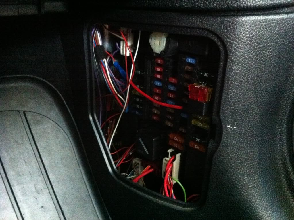

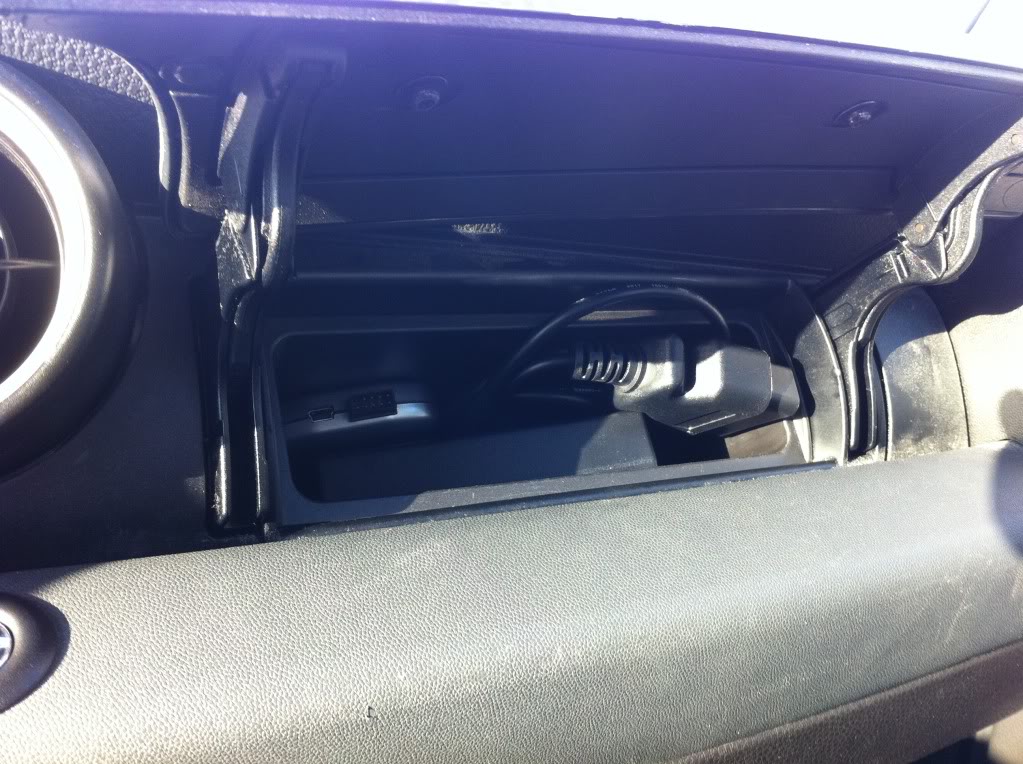

From there I ran it up to the "secret compartment". Popped out the plastic box and drilled a hole in it.
I installed the nozzle just before the Throttle body. (Has been moved further away since this picture)

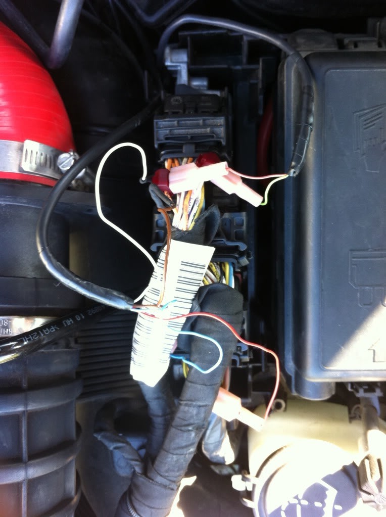

I brought it in to Rush Motorsport's in San Diego to have the ECU wired. They tapped and soldered the wires.
I cleaned up all the wiring and this is the final result.

Now the actual valve flaps themselves are merely free falling self closing rubber diaphragms, there is no spring or piston actuation on either valve flap, however there is a sprung chamber diaphragm, which opens/closes under the vacuum draw from both the inlet manifold and turbo vacuum draw, this dictates the flow direction, and in the later re-designed cam cover allows excess pressure to vent through the inbuilt pressure release sprung valve.
There you have it. No more carbon buildup.

23. 2/9/13- I also had to go out and purchased a used Netbook to run the Dimsport tool. Main computer is a mac.

This wasn't to hard of an install. Took about 3 hours total.

25. 2/25/13- Got this in the mail today, it is an awesome device.

Just ordered a OS Giken LSD and GT clutch from Way Motor Works. Will post pics as soon as they get here.

Clutch arrived in the mail today. It is a little special as it was put together just for me. I lucked out, they were out of stock but OS had all the parts laying around. So they put one together the same day and shipped it out. Good guys. Also, my Carrillo rods are on the way.
OS Giken GT
OS Giken GT

Pistons- Supertech 10.5 CR (+.5mm) 77.5mm bore.
