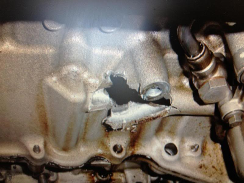

so legit..
we have already seen what happens with poor tuning.

Surprised you didnt post this Gabe. Everyone loves to see carnage :P

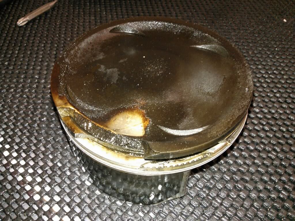

While we're on the topic, here's a pic of my subaru's piston after I built it with a 20g and supporting mods, the oem pistons(high in silicon and cast) couldn't handle a few knocks at a tuned 330awhp, I went with wiseco forged and got retuned to fix the knock issue . CHEERS!
