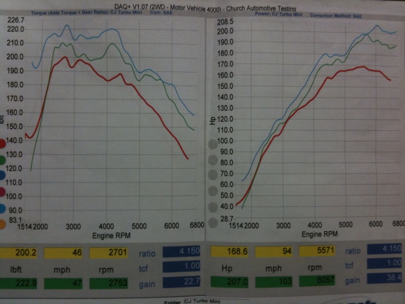

A friend of mine had his Mini tuned, he gave me the sheet to post for him. Since I would never tune my mini and ruin my warranty. He told me the red lines are base, the green are with the tune, and the blue was with his meth turned on.
He told me that Jan told him the highest numbers are coming from cars with stock intakes. So when he got home he took off his $350. carbon fiber intake and put his stock one back on (with the unifilter), and the car pulls even harder and feals faster. Some one needs to take their stock intake with them when they go see Jan and swap it on and off and see for real.
I know if I ever get my car done, thats what I am doing.

Jan, Any info on the statement about the stock airbox Vrs. CAI systems after the tune? I know there are many variations of both but what is your opinion?
Thanks, I think most of us value your opinion on this.
