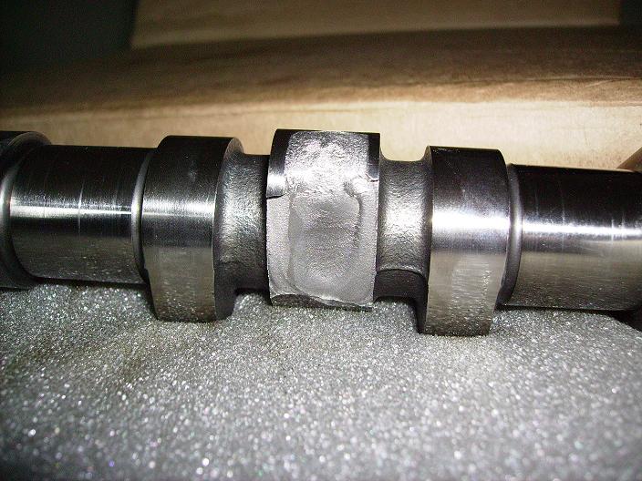

Now for some "NAZRIN" logic............ follow along
so by his "expert" opinion any cam that breaks is a poor design so with this brilliant logic in place let's put it to good use
exhibit A......... stock broken camshaft out of a MINI COOPER..... NOT a MINI COOPER S but MINI COOPER NO LESS
Wow... MINI uses crap foundries.... right Nazrin?
So based on this .... anyone using the stock camshaft for regrinding their cam on is using known parts that fail.............. So how do you feel now knowing you have bought a cam with inferior casting?

I understand the intent of that analogy, but let’s remove the propaganda aspect and look at the reality. Any material defect in the OEM core would be exposed immediately during the regrind process. The NS core’s integrity is triple checked at Crower. A regrind is actually the safest bet.
The rocker roller is many time harder than the camshaft’s lobe, the first place to look if lobe damage is detected would be the roller. In the MINI rocker photo below the roller pin is offset, probably due to inaccurate cross-drill during manufacture. This misalignment caused the roller to be dragged across the cam lobe’s surface diagonally damaging the cam it was acting upon. The needle bearings within this roller were damaged as well.

Jan, just for your info, and a little cam knowledge for you and ure little gang:
If a cam gets one flat lobe it is caused by something doing it to the cam and its not a bad cam. EVERY cam grinder in the world will tell you that
Now, ure credibility as someone who claims to know cam science can also be called to question
