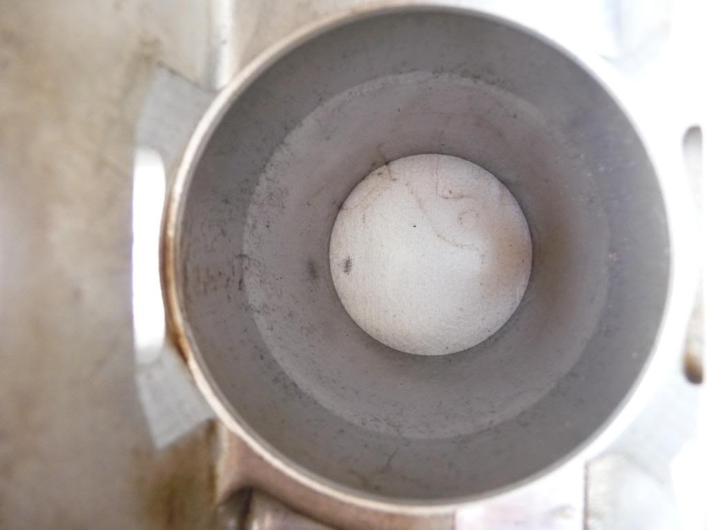

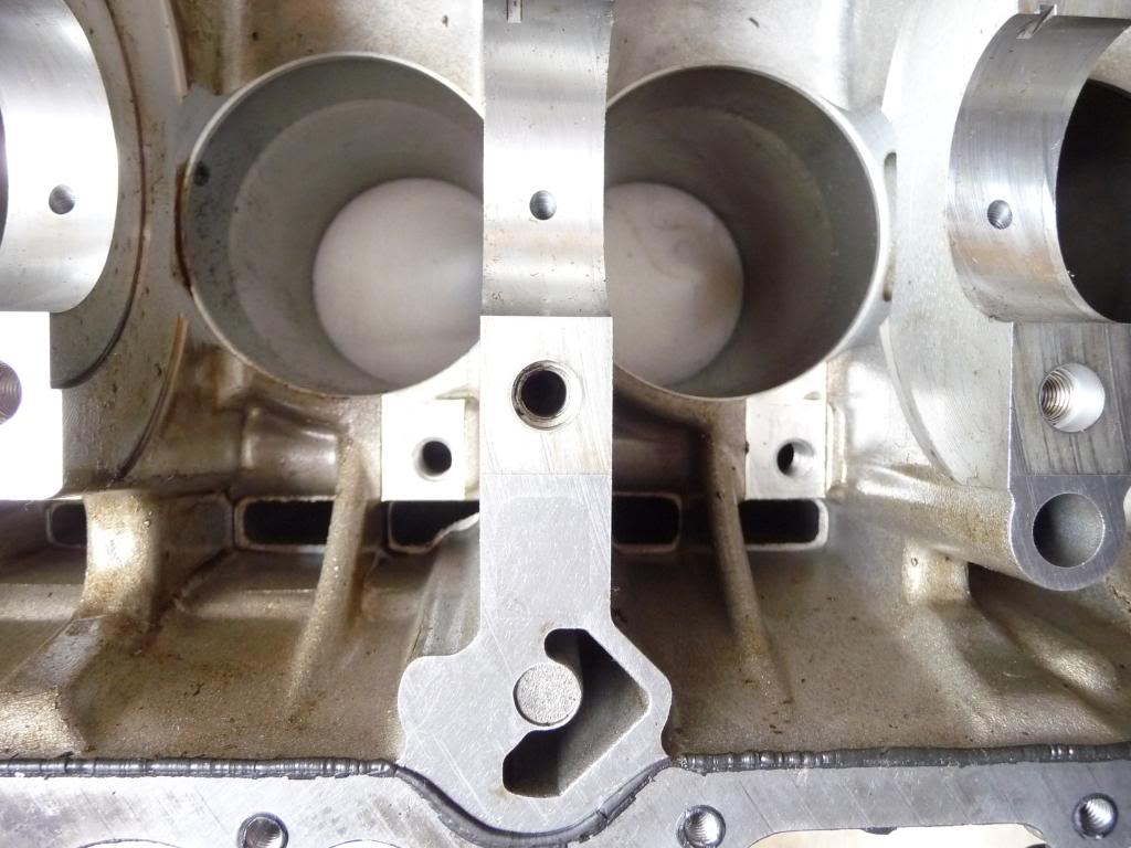

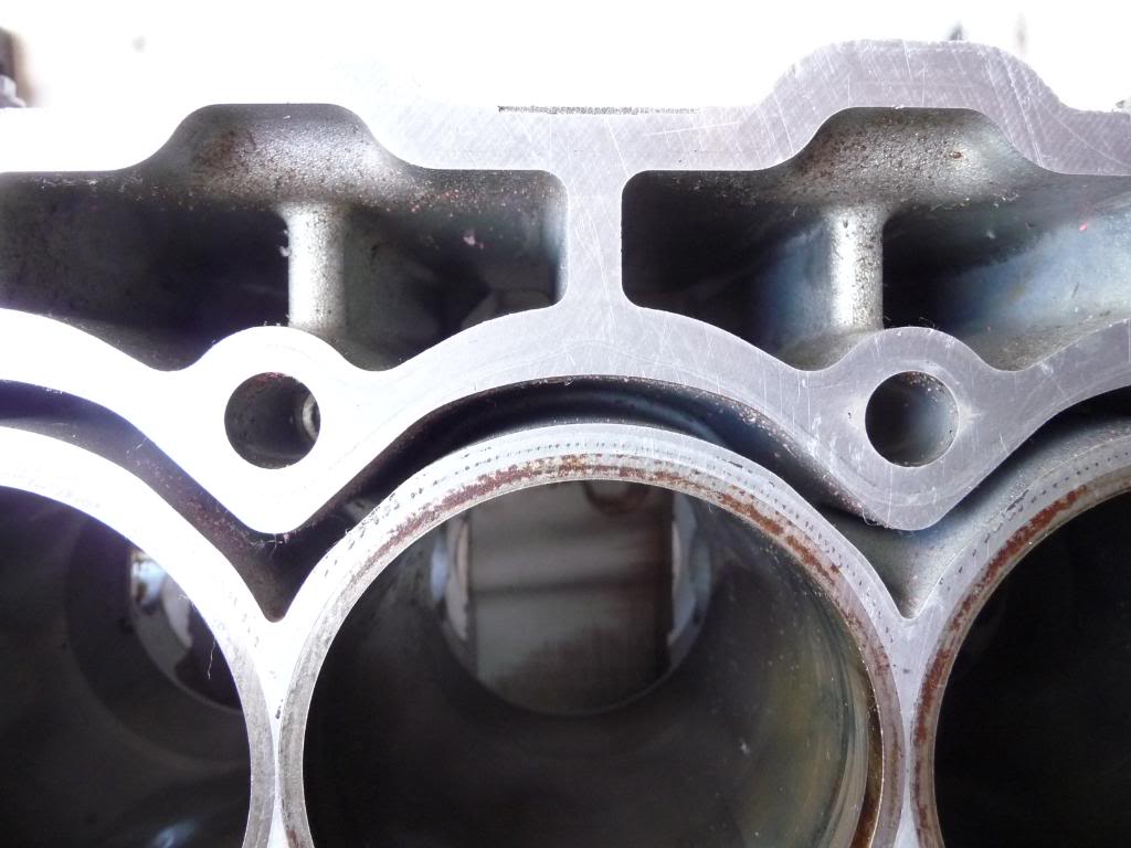

Has anyone bored and stroked there motor yet so they can utilize a bigger turbo maybe go to like 2.2 or even 2.4litre so you could run a really nice 50trim setup like the srt4s are notorious for running just curious? 1.6litre is small to be running a bigger turbo setup. Even just 2.0litre would be a decent improvement and is there any reason these things can't be attained such as the cylinders being to close together and due to wall thickness that there would be issues with heat? Maybe one of the techs on here could inlighten me on this! Thanyou for any and all responses!!

Here are a few photo's to answer your question, as to the difficulty regarding increasing the bore size, on the N14/B16 engine.

Wow pistons are very close together those pictures don't show much promise .. Thankyou for thos pictures!!
