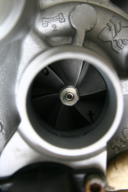

The JCW does fall on its face above 5000 in stock form. What you are feeling it TQ dropping off. Even with our ALTA AccessPORT and tune it drops but still makes more power. Here is a graph for you to see that.
There is only one way to get rid of the drop off in power, and this is the solution to that.......
how dare you tease us like that.
(I have my core ready)

I think what Jeff is showing you there is the inside of a JCW turbo. I've been working with Jeff closely on my 09 JCW. Alta is the real deal. I'm running stage 3 + an upgraded turbo. The power and torque is so much more then the factory car. It's a must have. Drivability is much much better then stock. And even with all these upgrades I'm still getting over 30mpg. I recently went to the drag strip running stage 3 and factory tires on a cold day and ran 13's @105mph. My car impressed a lot of people that day. I think once we get this stage 4 set up dialed in along with a better clutch, limited slip diff, and drag radials I'll be in the low 13's and possibly high 12's. Yes I know the mini isn't a drag car. But when you feel all the torque it has you'll want to race for the fun of it.

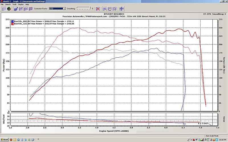

09 R56 with K04 42mm Compressor & Turbine upgrade will do
Attached Thumbnails Hybrid K03 Turbocharger-paw-r56-bill-k03-upgrade-245.97hp-249.38ftlb-std-dynojet.jpg

The p/n on mine is 5303 988 0146. The compressor wheel is supposedly ~41mm. Never had the opportunity to measure though.

The Challenge turbo(never had my hands on it) should be the same as the JCW turbo. The Compressor map for the JCW turbo shows it flows about 25lbs/min of air (250 engine HP) which is more than the JCW is rated for. Just like the MCS turbo is rated for 210HP.
