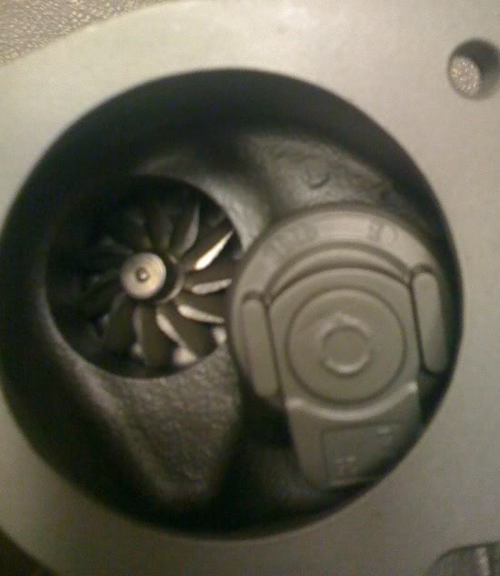

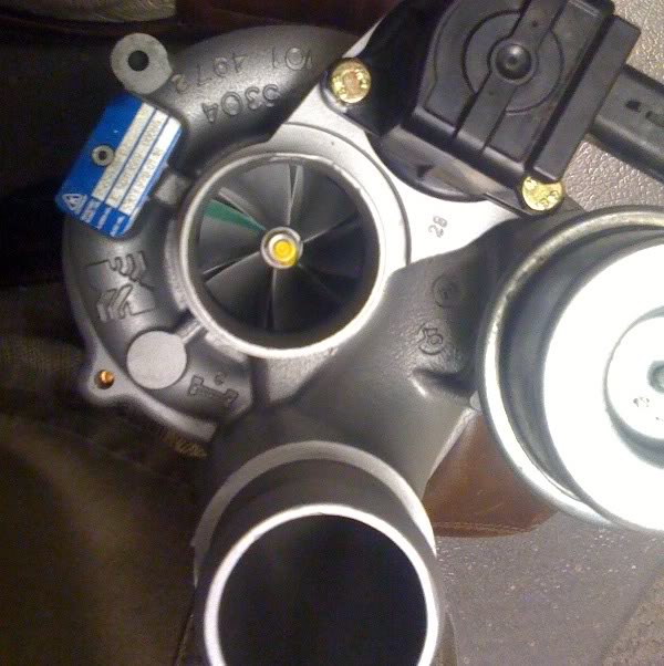

Pictures of the upgraded K03
I took these with my phone at work. If anyone wants me to try some better pictures with a real camera just let me know.

It looks like they clipped the turbine wheel. Did they say why they did it? Also did they have to machine the turbine outlet at the wheel? It looks like the wastegate flapper is hanging over. If that is the case, how thin is the wall between the wastegate hole and the turbine exit.

Wheels
The shop said they will not give the exact part numbers or sizes used but that the turbine wheel is a larger wheel and was clipped. He said that they seem to have good results from these wheels with the audi turbo upgrades.

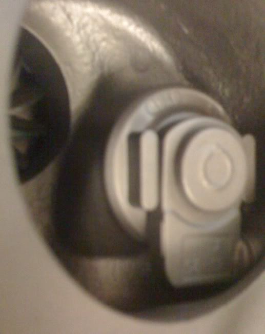

Here are two more photos with my phone showing the exhaust side and space between the flapper and outlet.
