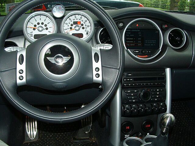

I got the autometer quick shift lite to work in my particular application which might not work for others . I wanted the lite to go on at 6k just to let me know when i was in the high rev range when playing in the canyons. With the motor sound and tire noises etc i found myself rounding a corner seeing a short straight and gong for more only to hit the rev limiter as I wasn't aware i was quite that high in the rev range. In any event i got it to work for that particular range by connecting the signal wire to the black and red wire coming out of the back of the coil pack. The trick is that this doubles the RPM number but by putting the stock 3k " pill " that comes stock with the lite I ended up with the 6k signal i was looking for. Bottom line is you want it to go off at 6k that's a easy deal. Anything else and you need the Pilo item.If you really want a superior shift lite try the Gtech Pro. That is the little console on top of my dash in the picture. It has 4 of the brightest leds I have ever seen. As i get to 6200 one goes off, 6400 / 2 go off , 6600/ 3 go off and 6800 all 4 flash. you CAN'T miss it.You set the red line as you want and it steps itself up to it automatically. If i had bought it first I probably would not have bought the autometer unit. Randy
http://www.maxmini.net/images/newpics2/shiftliteCA.jpgPage Titlemaxmini home site

andy@ross-tech.com's Avatar
andy@ross-tech.com
Joined: Oct 2002
Posts: 3,652
From: Lansdale, PA
And I thought my dashboard was "busy". LOL

What is the gauge in the middle for?
Old Oct 28, 2003 | 01:44 PM
Thechandler81's Avatar
Thechandler81
Joined: Jul 2002
Posts: 560
From: Chicago, IL
WOW!! that is one busy cockpit!
looks pretty nice though.
