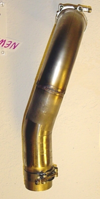

u need one of those..
No, I believe that is a one-ball pipe. You actually want one of these...
Note there are two versions, one for the "original" JCW exhaust and one for the factory verison. The original is just bolt on, the factory requires cutting to install, and so is harder to reverse.
50k miles on my resonator-less JCW and still loving it. Really barks at wot and high revs.
