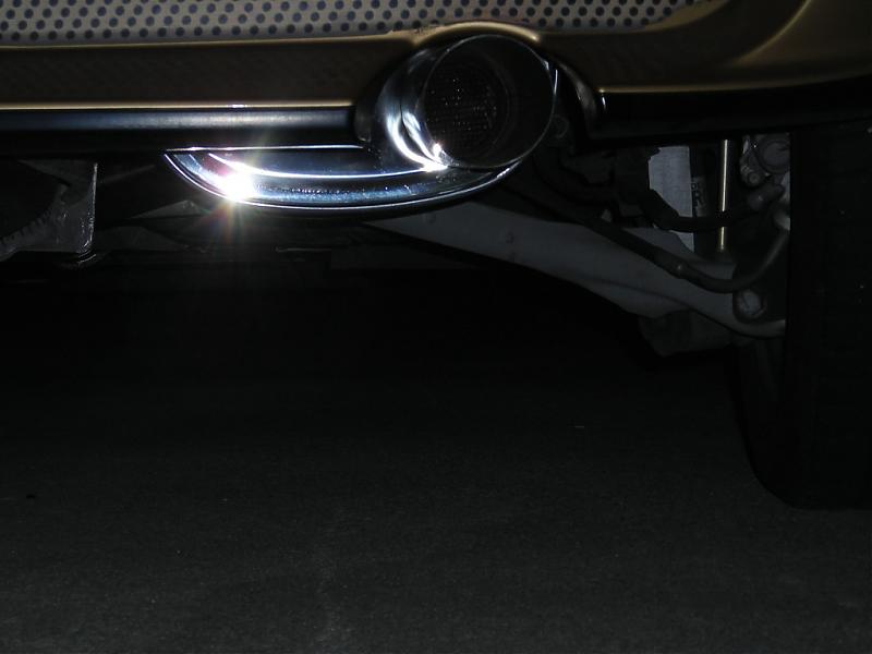

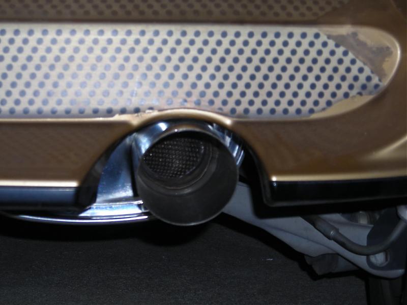

Originally Posted by kurvhugr
Hey Art (and Zip), any feedback yet?
Well, I just got back from installing it, and it took about an hour to remove and reinstall the the new exhaust. The hardest part was working the bolts under the muffler and reinstalling the rubber spacers. I don't have to much space between the tip and the rear facia. It looks to be less than a quarter inch. I will have to watch for burns or melting... But oh the sound is sweet. Much better than the posted clip. I am very happy with the whole sound
Art
Attached Thumbnails New Exhaust for MC.  What would you like?-megan-above.jpg   New Exhaust for MC.  What would you like?-megan-below.jpg   New Exhaust for MC.  What would you like?-megan-clearance.jpg
Art
Yeah, that's pretty close. Did you take that pic when it was hot or cold?
It was hot it was a 12 mile drive from the shop.

Aquasar, which rear bumper is that? Is that anything aftermarket? I'd like to grab attention to that because there is definitely some clearance issues happening there and I don't want to see anything happen to your bumper.
If that's a little bit too close for comfort, which I believe it just might be. One idea that I can think of is to utilize washers as spacers between the chassis and the rubber hangars in the rear. This should bring the tip a little more downwards. However, this also might cause a clearance issue with the Middle brace that holds the exhaust into place.
You might have to flatten the middle of that brace in the back to give a little more clearance if that becomes an issue. Please let us know.
It's the OEM "bodykit"....it has the same exhaust location and cutout size as stock so the stock exhaust can fit .
I would definitely look to see if the mid pipe is upside down....it may not appear that way, but mine didnt either. It took me almost a year to realize that . I just fixed it by "persuading" the rear hangers (before i knew how simple the actual problem was)
