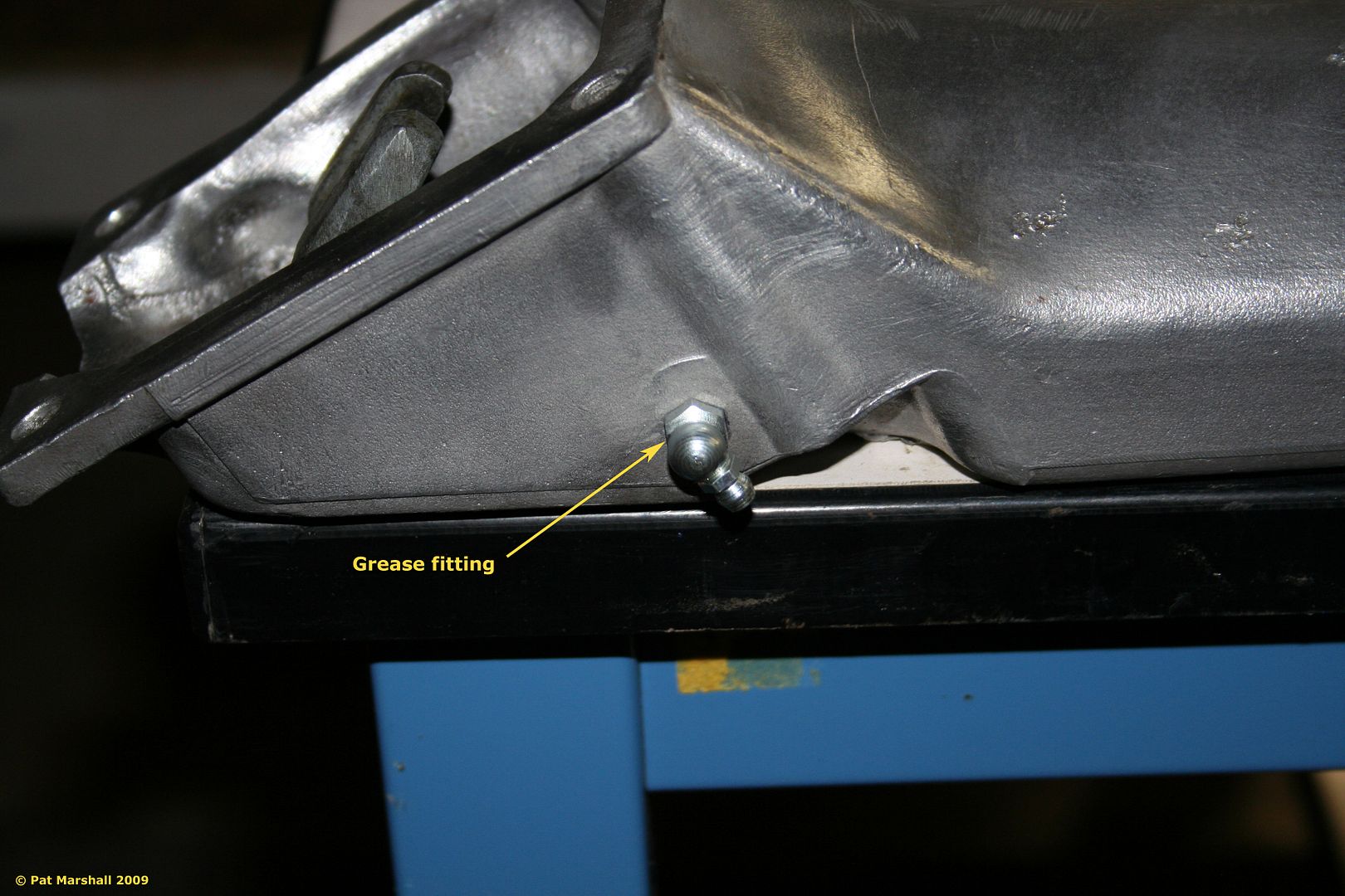

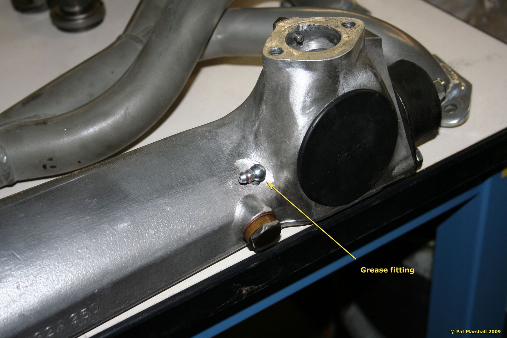

Those can get pretty nasty inside, especially if the front rubber half moon seal is missing or rotted away.
Here is something you might want to do, add grease fittings. Also hit the shifter casing with a wire wheel on the drill. Will look brand new!

Thanks for the pointer Pat! Does the case have to be fun of grease? Or just regularly greased?

No, just the two places that the shift rod makes contact with case. Greasing it just helps with the wear at those places
