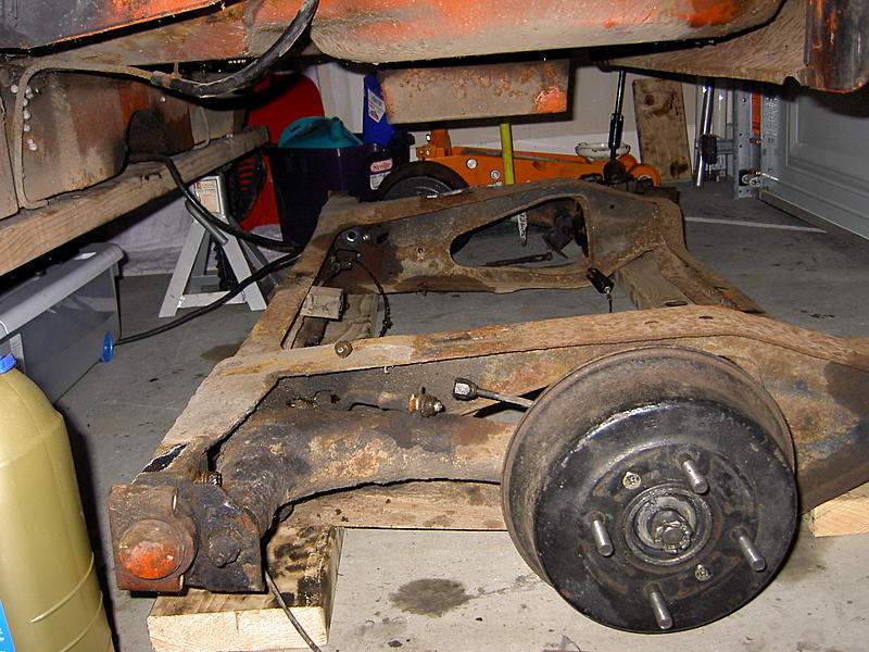

Rear subframe is out.......
You will notice that one radius arm is still on. I have a rounded off bolt that hold the radius arm to the subframe and I have one bolt that broke off. What are the best methods for extracting a rounded off 1/2" bolt and for extracting a bolt that sheared off flush with the radius arm that is still through to the subframe?

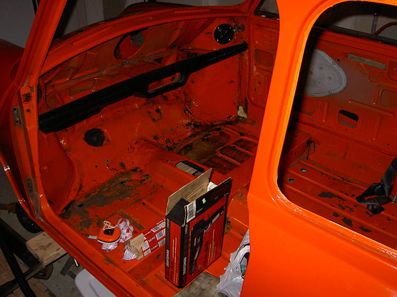

Last pic - the interior os looking barren....
