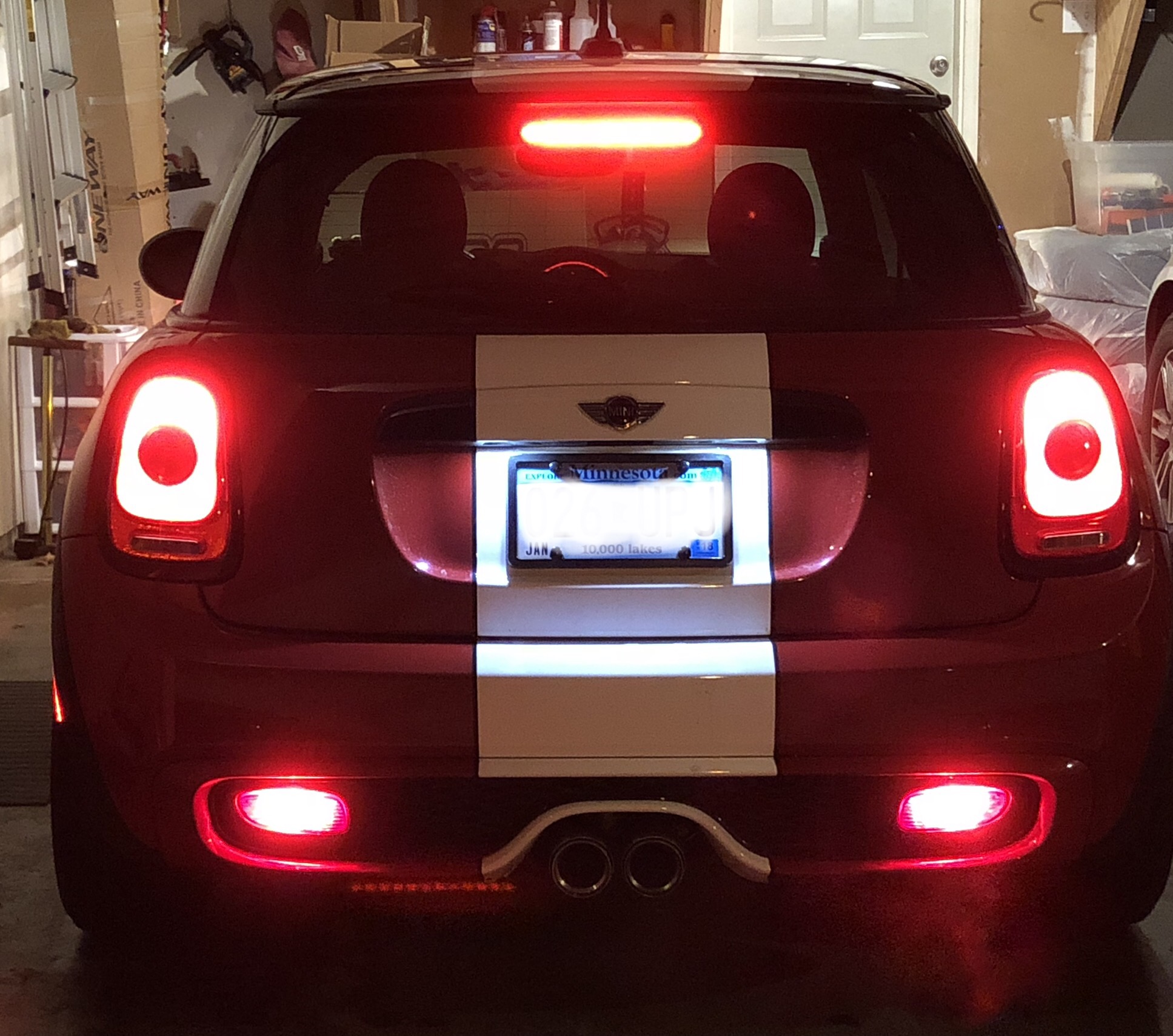

I found this on another site and tried it out. It works! I'll post a picture
Rear Fogs as Brake Lights:

Finally! Man I’m such a slacker.
Rear fogs coded to work as another set of brake lights

Do you also have the fog switch?

Nope, just for my fronts
Id rather have rear brakes lights anyhow

I have the expert mode options and looking to make the bottom fog lights work with the break lights if its possible, I don't have a toggle switch for the back but do for the front, is it still possible to code following the steps above?
It's been talked about in this thread above, but it is a simple matter of changing the output:
BDC_BODY
3065 LceLampMapping4, ED
Funktionen
MAPPING_BREMSL_2_L_OUTPUT
Switch to this
nsl_l (this is the rear fog light choice)
You need to do this for right and left. Above is for left,
For RHS just change the l to r
MAPPING_BREMSL_2_R_OUTPUT
nsl_r__________________
