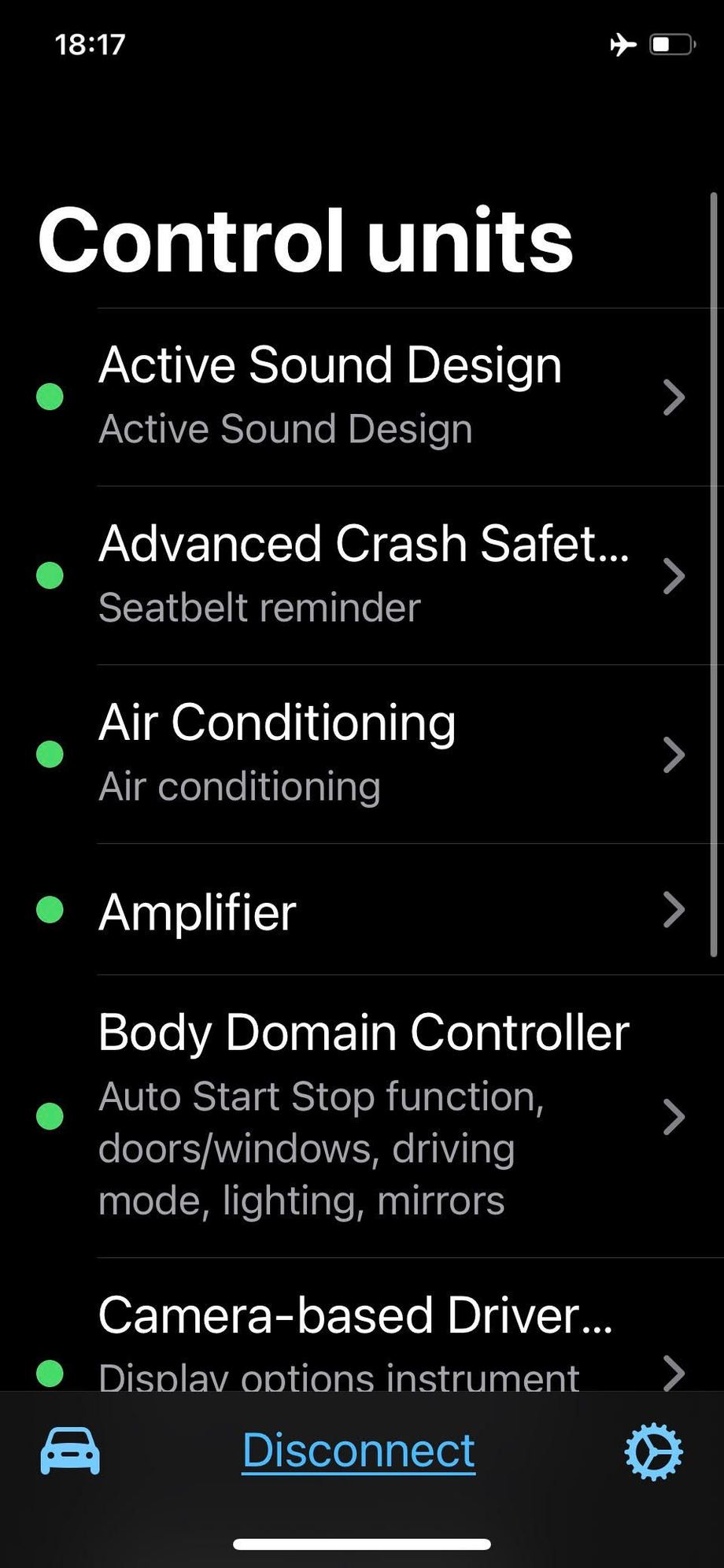

I hooked up Bimmercode to my 2019 Countryman and was unable to even find two of the things I wanted to code.
I was hoping to code:
- Fullscreen carplay
- Get rid of the startup warning screen
So, I'm guessing my software is indeed too "old". Is there a way to upgrade the software. Is the only option something like this: LINK. or do dealerships do any type of updates? for a fee even?

So...I went back in and started checking the Expert Modes for each of the Control Units available (screenshots attached) to me. No luck for either a warning or Carplay... or ID6 for that matter.
I've heard that there may be a software update that may have made these available to me (behind the scenes at least). Am I making this up or how would I get MINI to update my car.
Thank you!

No need for including the dealer. Through talking with @sb2002 , it seems there's a toggle in the settings for Bimmercode "Ignore Headunit". I turned it off and boom the headunit control unit popped right up. I was then able to select right away the fullscreen and warning.

Anyways...assuming you already have CarPlay (just not fullscreen), then you need to purchase the Bimmercode app for your phone (I believe 39.99 for IOS version). Then you need to purchase an ODB adapter. They come in bluetooth or direct connect. I went the direct connect route. Bimmercode has a page on their site of all that work. Direct connect, you're looking at 43$ and bluetooth about 80$. Direct is faster...
Then get all connected (Bimmercode gives directions on how to do that). Big thing I needed to do was to select on the Gear icon in Bimmercode before I went in to code and turn the toggle for "Ignore Headunit" off. When I did that and went in to code (simply by selecting "connect" in Bimmercode, the "headunit" controller option was available. Once in there, under Carplay will be "fullscreen". Go in and change to Active. That's all I had to do.
You may need to go into Expert mode and find "Carplay_fullscreen" and change to Aktiv.
The toggle switch was my big hangup...but other that it was fairly simple. And you can also adjust other things in Bimmercode....so you're not spending 83$ strictly for fullscreen.
