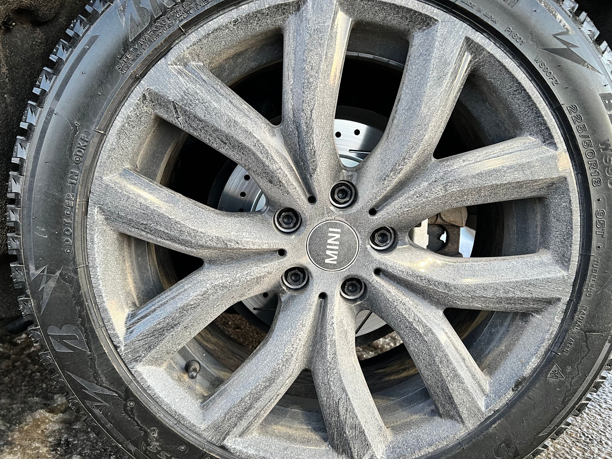

I put PowerStop drilled and slotted rotors and pads front and rear on my F60 CM. The rotors were due to be replaced as they had developed a slight vibration and I also suspect that the pads were a bit glazed. They were cheap Chinese crap that came with the car when I bought it 2.5 years ago.
The new brakes are a big upgrade and I stayed with the OE rotor diameters as they were quite generous from the factory. I also upgraded to DOT4 fluid (because why not) and the brake feel is very nice with a really progressive feel and excellent bite, even when cold.
I bought them from Rock Auto. They were very attractively priced and a great upgrade for this track day enthusiast amd racer (though not in this car!)
These are the best shots I could find. It’s winter here so please excuse the dirt and grime. If you zoom in you can see the rotors.

I think I'm also due for pads soon, which is also causing me to think that now is the time.
Will the car give you a notification when you need some (I heard there is a wear sensor)...or do you tell via the "old fashioned" way of the grinding/scraping noise from the pad indicator?

I replaced mine with the Powerstop front and rear (rotors/pads) and very happy with them. Performance and wear improved.
